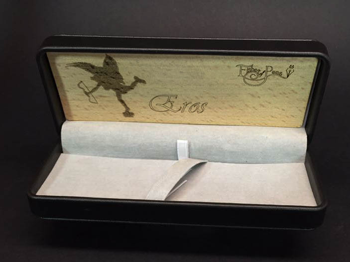

The silhouette is done at 30% 300/150 with an outline of 15% @ 30mm/s and the others are done at 17% @ 30mm/s. Then cutout at 30%. Getting the hang of the multi-operation thing now.
Fantastic results! Thanks for sharing with us!!!
Your results are getting nicer every time I see one
