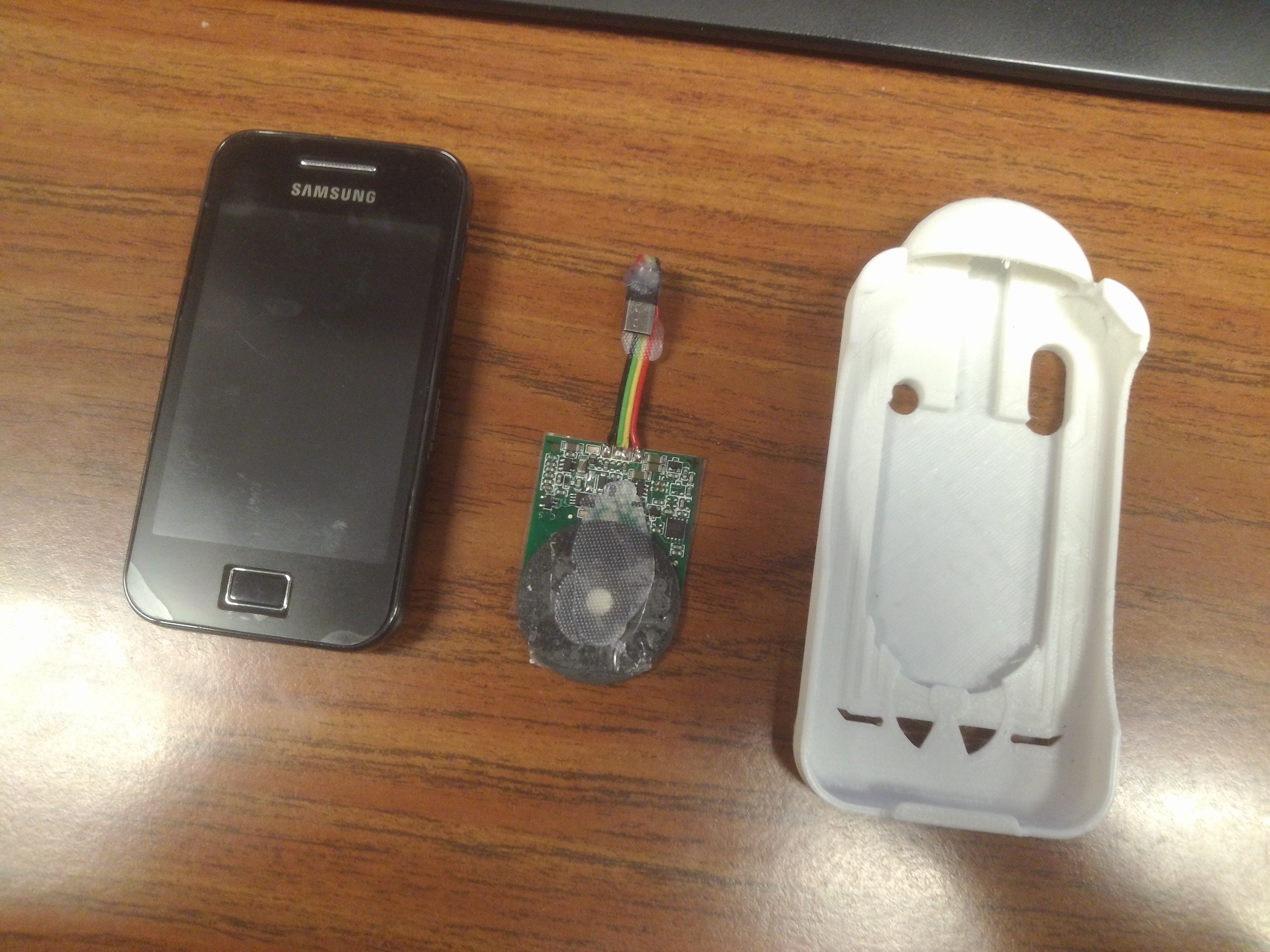

The Source (aka Radio Shack) was blowing out inductive charging cases for old Blackberry phones a while ago. I grabbed a case & base for I think $10CDN. My Galaxy Ace does not have the required contacts inside for a proper inductive charging case.
A couple weeks ago I had the epiphany that I could solder a USB cable to the board and print a custom case that would hold everything in place and protect the cable when plugged into the phone.
I found a case design (edit: http://www.thingiverse.com/thing:311997), imported it into Tinkercad and extended it to hold the inductive charge board - https://tinkercad.com/things/8YKsIOxQD7G.
Uploaded to Thingiverse - http://www.thingiverse.com/thing:587231
