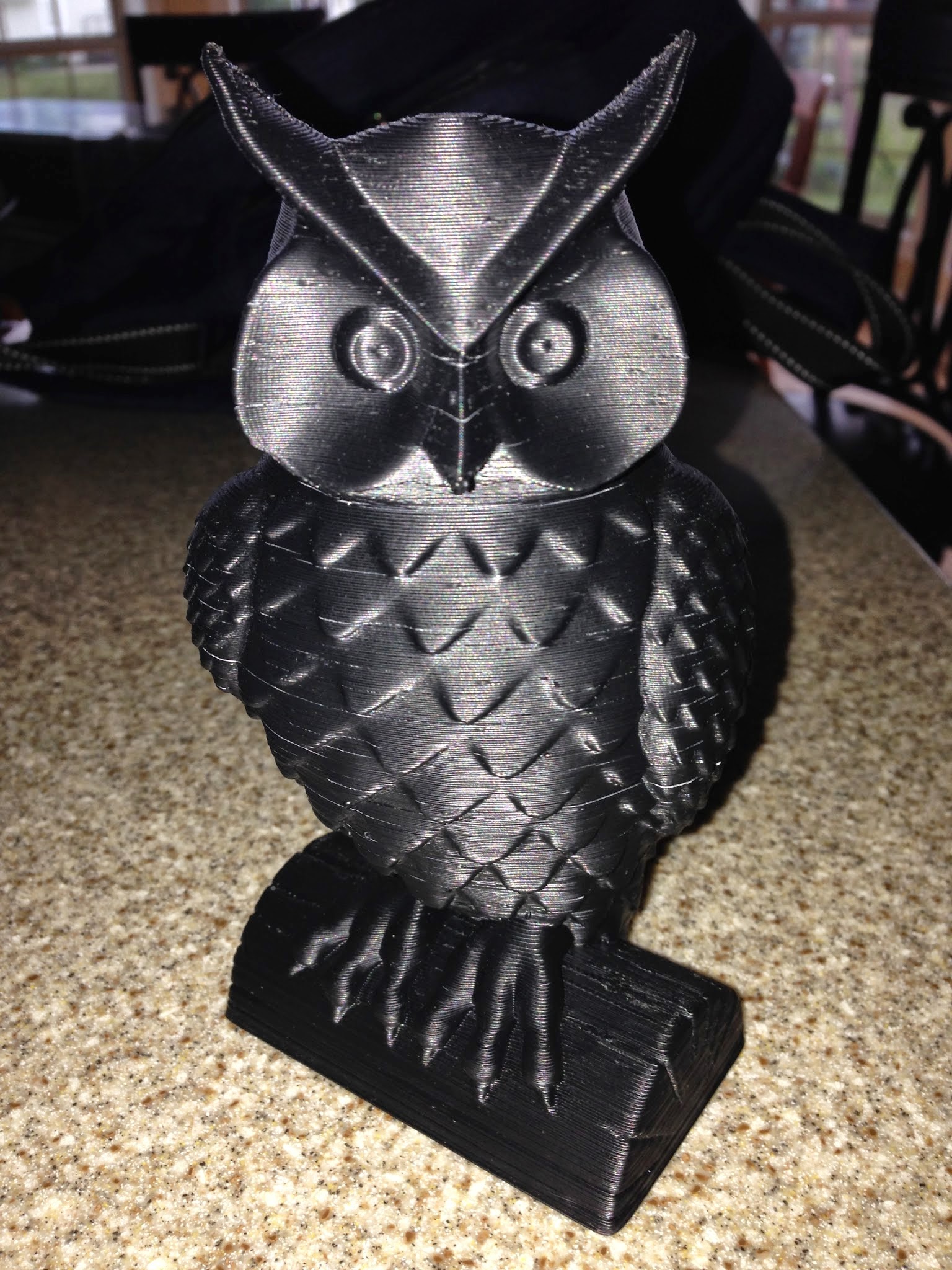

The Thingiverse Owl printed really well! It is on my desk at work and
The Thingiverse Owl printed really well! It is on my desk at work and everyone loves it! It is about 7" tall. While I was at it, I experimented with speed and printed the spiral vase. It only took slightly more than an hour. I printed at .3mm. Not as nice as my red vase printed at .2mm. However, with the increased speed and larger layer, it was printed in probably 1/4 the time! I also printed the female bust that is on Thingiverse (not pictured for obvious reasons). That was my first print at .1mm layer. It looks fantastic, and really showcases what my printer can do! I will have to find another model to print at .1mm so I can actually put it on display.
Strange thing about the vase. I put water in it a few hours after it was done. It did not have any leaks. I tried again about 10 hours later to show my daughter, and water started to seep out in some areas. I have only printed in ABS so far. I should try PLA now.
