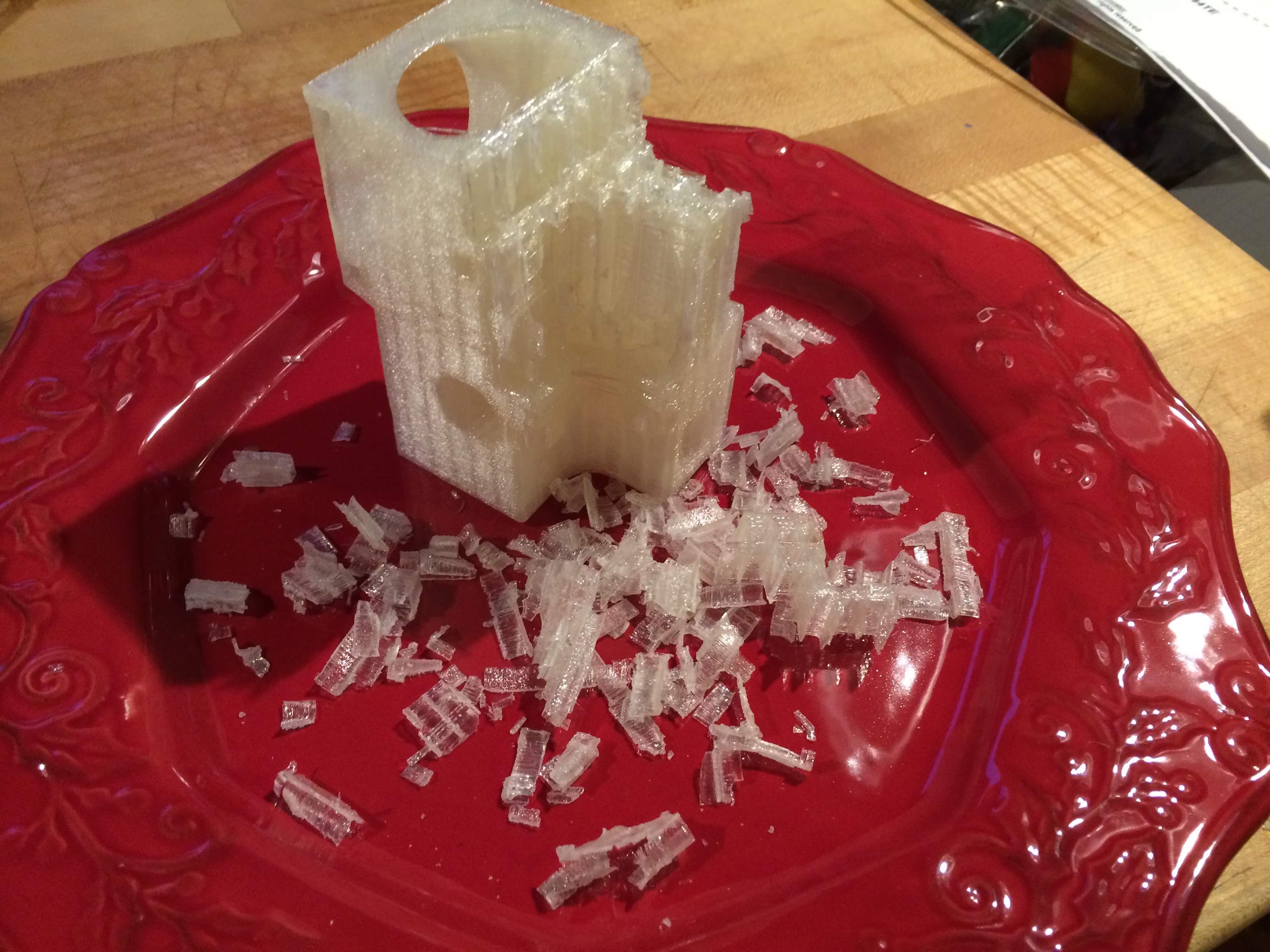

The thrill of coming down in the morning to a successful print…the agony of it having impossible to remove supports.
(Suggestions for Cura to get it to create supports that release easily?)

I had this same problem with Cura and increasing the support offsets, vertically and horizontally, helped a lot. Higher hotend temperature also seems to make the supports harder to remove, which sucks because I like printing hot.
I will have to try the thinner supports as well. The dremel works to get it off but what a pain.

Print in anything other than PLA. Cura supports are pretty good, but hot PLA is too sticky to ever get really good release.
Boy, you’re not kidding! I threw some ABS on last night, managed to get it to stick well enough to print a significant percentage of the print. The only place where the support didn’t come off completely was where warpage ruined the geometry. I’m rerunning using meshmixer and superglue on the dots to hold it down. (Theory: If layer adhesion is the problem, use meshmixer to orient the part so that there’s not a lot of layers to adhere!)
