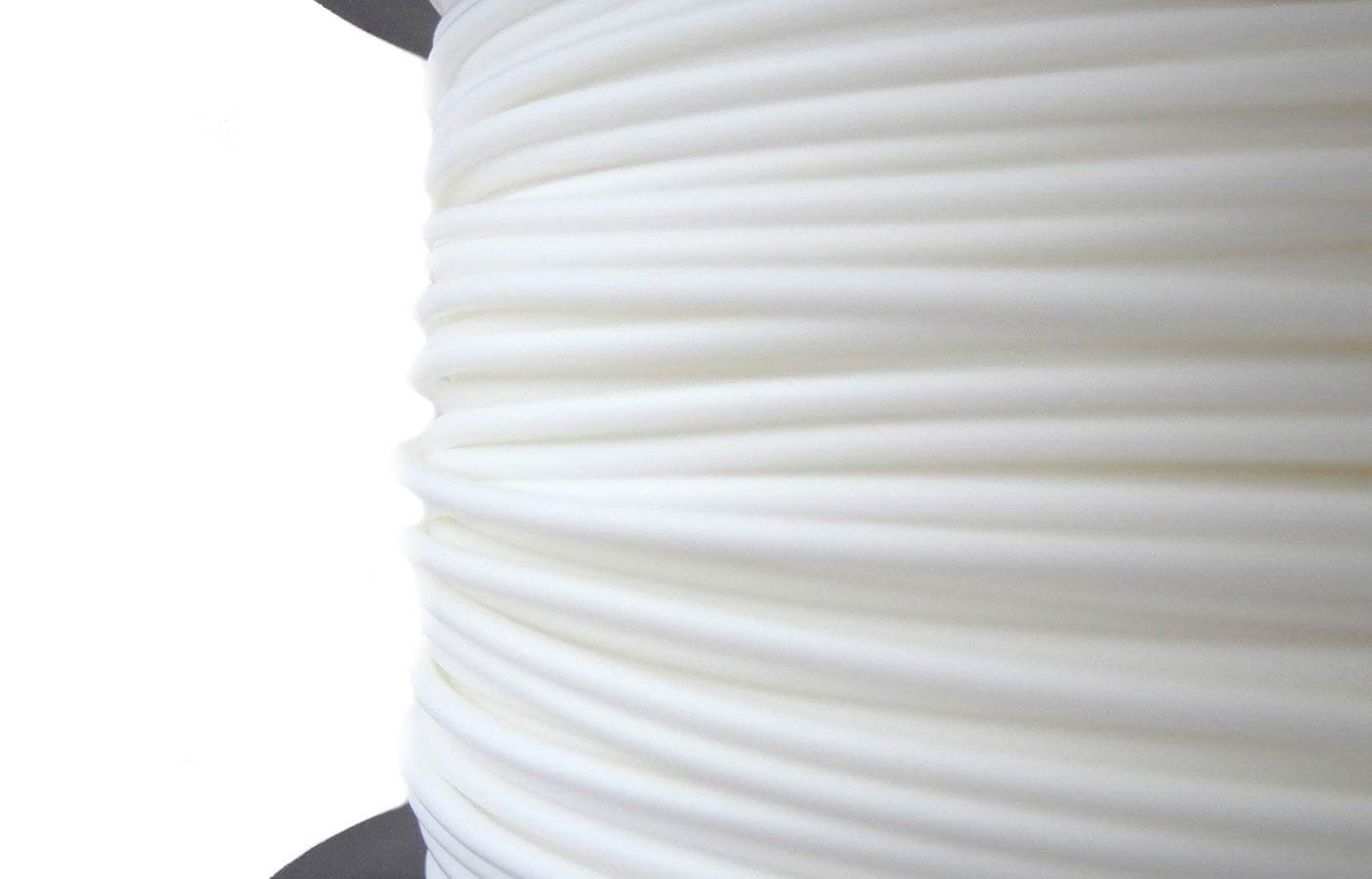

Who has tried polysupport?
Like it. https://plus.google.com/116850909992233145832/posts/S6XhG8AeH4a
@Markus_Seidt some in your post are complaining about the price. Well. Seems pva is more expensive in germany… Did you get it to work with PET? Would be nice
@VolksTrieb , 40 € for 500 gr is not exactly cheap I’d say. But with advanced slicers like new Cura, you might use it only for the interface layers between the part and support. PET and support is still on the list. But with PET I sometimes see the nozzle dragging junk over the print and leaving a brown lump every now and then. Want so solve this issue first.
@Markus_Seidt pva is allmost 50€/0.5kg
