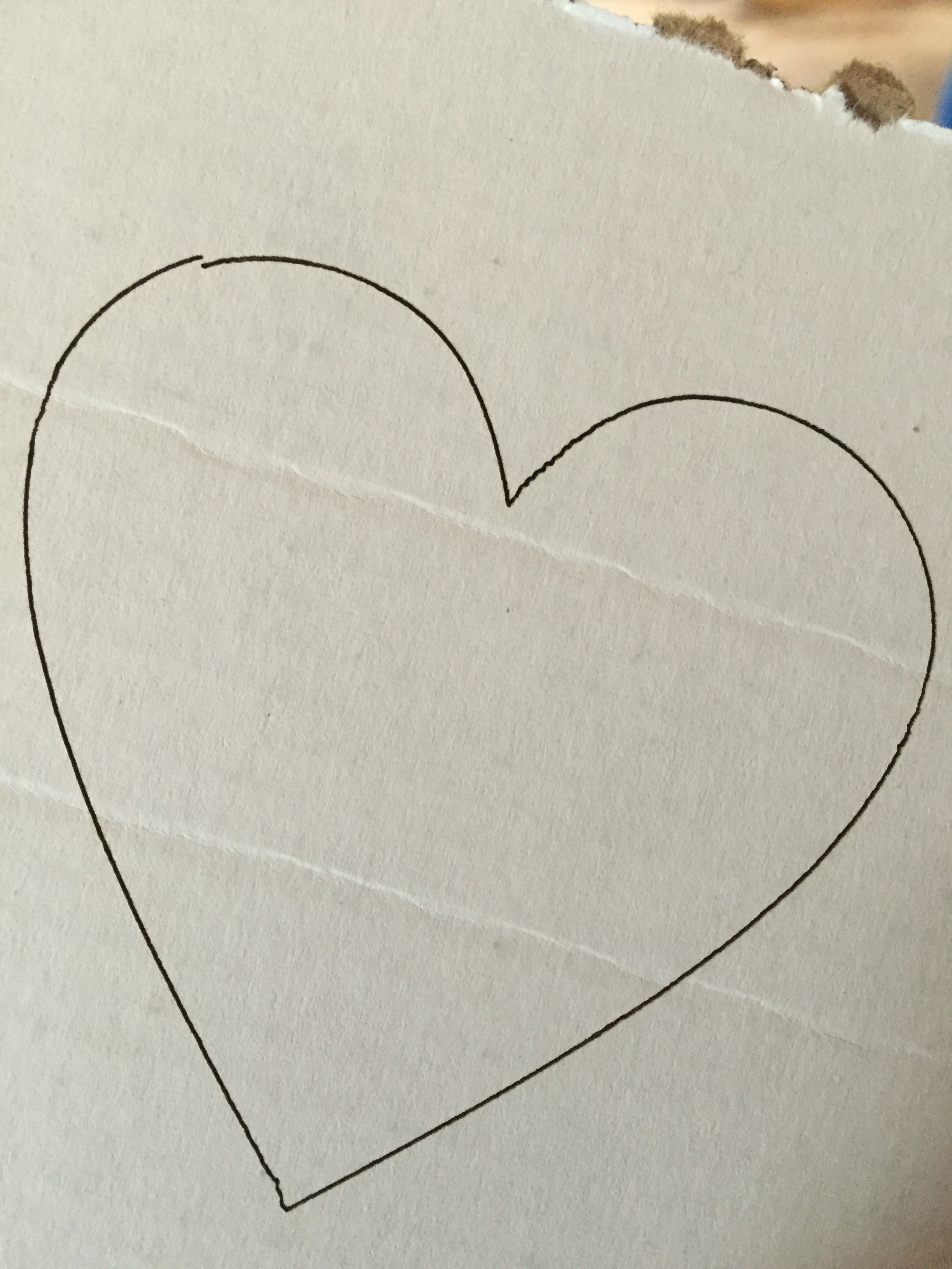

The top left of my cardboard heart doesn’t line up. Does this mean j need to continue aligning? Or is something else not correct?

What your seeing is a mechanical misalignment of the x y rails.

your stepper motors loose steps. this is very bad. try to lower your speed and if possible increase stepper power if you can do that on the drivers. Misalignment could be the reason why they loose steps
@Bart_Libert was cutting at 7mm/sec. Still have yet to check connections
steppers don’t have feedback, so somewhere in the path the stepper looses steps because of friction in the system
Hey buddy. Having just spent hours levelling and aligning my own K40’s bed, I can honestly say it takes time to do well. I found fitting a red laser diode to the top of the first mirror and a raised target to the second helped me get the Y axis (bed levelled in Y plane) spot on with no deviation up or down and left and right. I had the shim the rear left side of the bed up 4mm and the rear right 2mm. For the X axis, I did mount the same laser as a guide but measured the distance from the left guide rail to the side of the machine body, which seemed to work well. I have wathe numerous YouTube videos and between them all and my skills as an engineer have managed to figure out roughly what adjustments do what to the beam path, but there is more I can learn I’m sure. One of my belts felt slack on my Y axis so I tightened that to.
@greg_greene Looks more like the steppers loosing steps somewhere… Cutting slower would probably help that. I think there is only 1amp from the 24v side of things… So the steppers don’t get alot of power.
and if you have a marginal power supply to start with - you could be subject to less than the 1 amp
