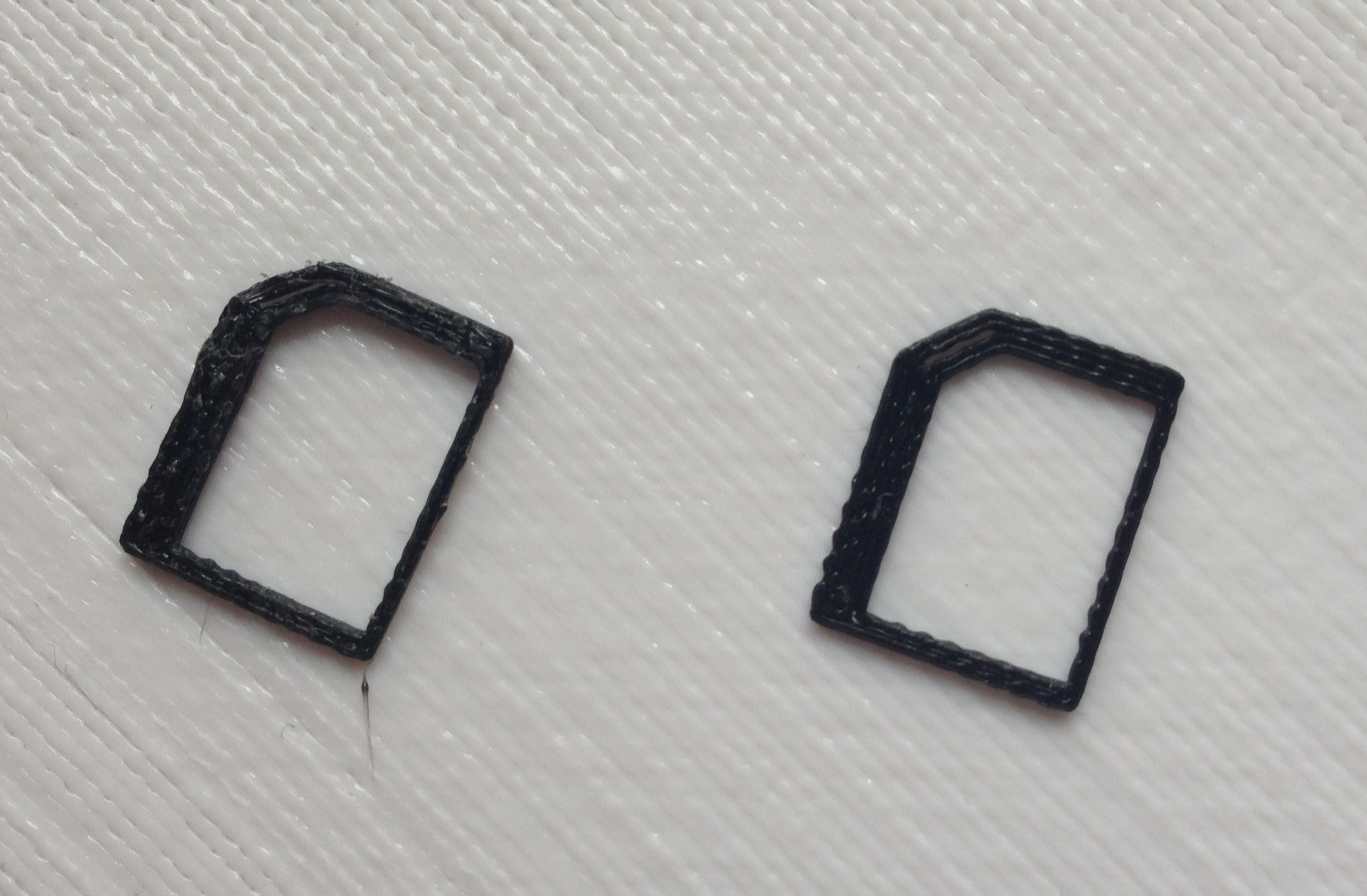

The two prints are printed on the same machine same gcode filament etc.
The two prints are printed on the same machine same gcode filament etc. The only difference is that after the left one I applied a liberal amount of singer sewing machine oil to the linear bearings.
Btw they are nano to micro sim converters give you and idea of size they are printed 0 infill but 2.4mm shell

I tried to find some but had nothing but blank stares at the local hardware, i thought id try the machine oil. I have used silicon spray that works but seems to dry out after a few days. The machine oil is better from what ive seen. Quietest the bearing have been, I think maybe due to viscosity.
If you have a nearby auto parts store, that’s where to look for the grease.
