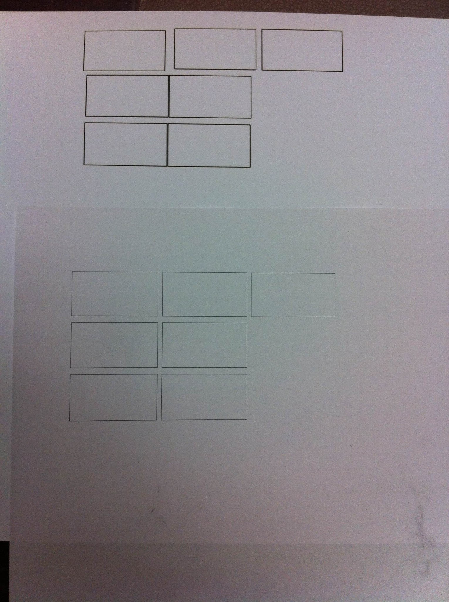

The upper photo is what the cutting machine does.
The upper photo is what the cutting machine does. The photo below is the one I print in the HP laserjet and is the same as I made in CorelDraw.
How I can correct this problem?
Make sure the paper isn’t moving due to draft. Also, you likely have a loose X belt. (There was someone who posted almost this exact issue further down)
The paper is not moving, I wll check the X belt.
