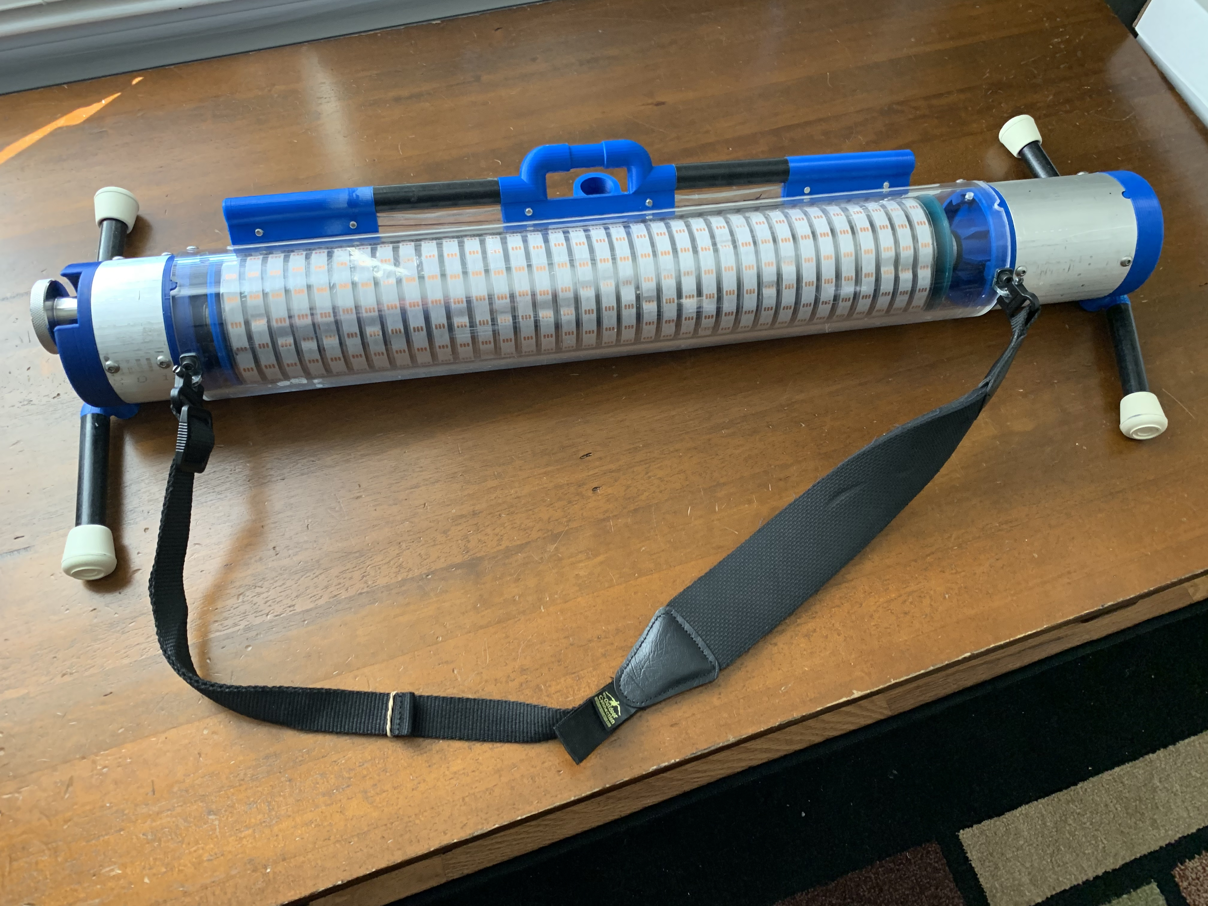

The World’s First Mobile Rollable Digital Display. I showed it at CES this year in Eureka Park. This version is a 2040 Pixel WS2812 smart lighting version with an iOS App. I have another version with 2400 Pixels that runs on FastLED using either a Teensy or Arduino MKR1000 using a single wire. With that version, I can run about 15 f/s Text, animation (fire) and rotating GIF (ie Batman logo). Rollable Displays are the future of Mobile and we are going to start with low resolution/Retro AI enabled mobile billboards.

@Phillip_Funkhouser : Very nice, what’s the pixel density? It doesn’t seem to be square.
@Marc_MERLIN Marc, Thanks for checking it out. The pixel density is 60 per meter. 60 pixels tall so 1 meter tall and it is 34 pixels wide so just over half a meter wide. 2040 pixels total.
