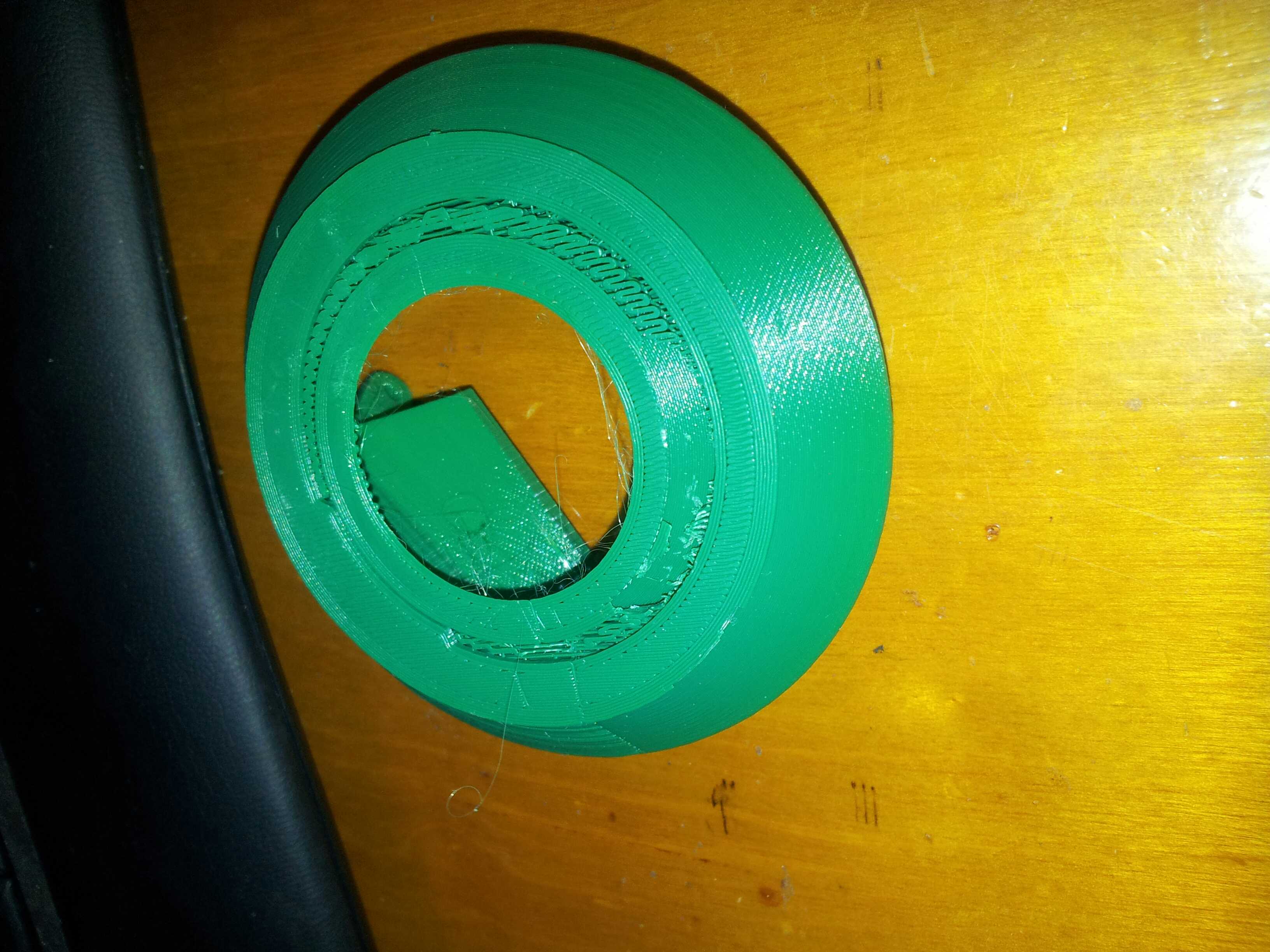

The wrong time to print supports.
Eustathios cooling duct, somewhat clogged.
Yup, this one should be able to print totally unsupported. Also there is some brim already modeled into the stl, so it should be ready to print. Is that PLA? If so I might recommend abs for that part due to it’s location by the heat.
Thanks for the heads up on the heating issue. I will have go to the lab for this piece.
