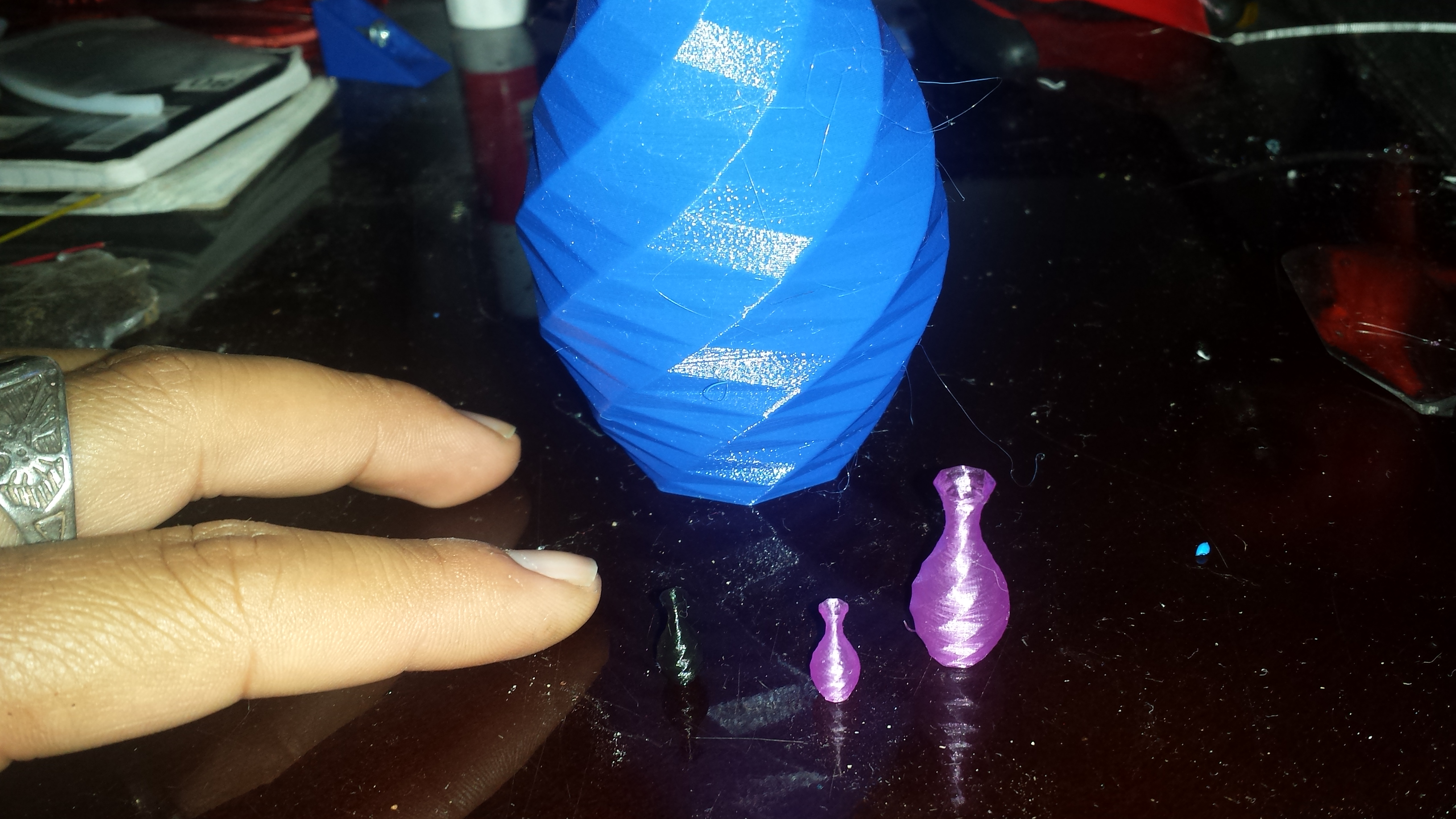

0.2 or 0.1mm?
Cool
.25mm nozzle printing at .05mm layer height on vase mode. Vase was scaled down to 10%
@Cristian_Martinez Pretty impressive :+1::+1: - which printer, and how long did those two take? At a guess, not too much faster than the original size, if any?
Prusa i3 MK2S and they took less than 5 minutes. The 100% scale takes about an hour
LOVELY!!!
Gonna try to keep going down till the printer cant handle it
Very nice!
It is amazing what you can do detail wise with a 0.2 nozzle at 0.05mm layers.
