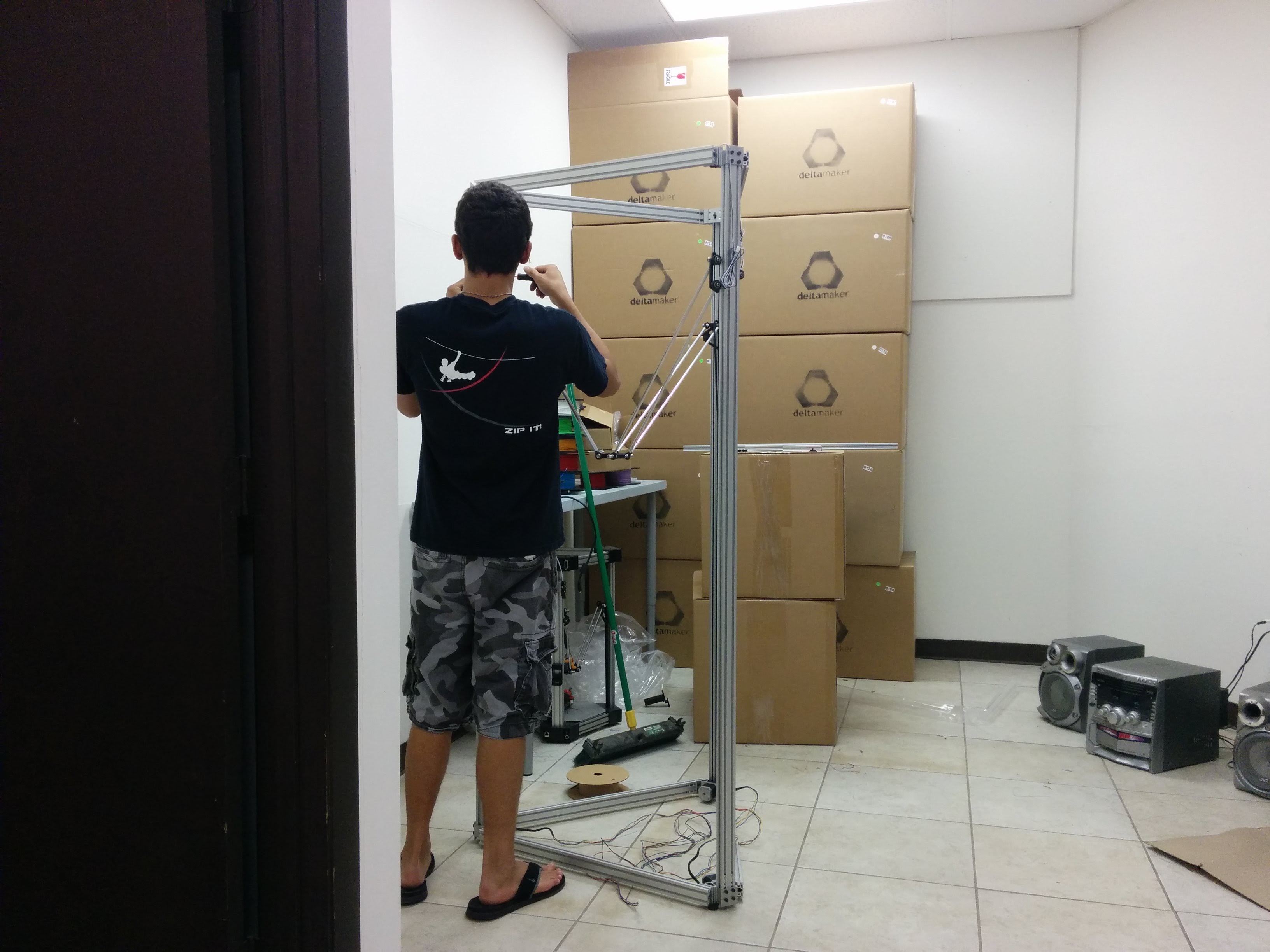

There are some people out there who believe that all I do is talk theoretics among another small group of 3D printer enthusiasts and that I don’t build printers anymore. I still build printers. I’m just building so many of them, and they’re mostly just variations of the same model, so I don’t post about them often. This is the latest build for the local MakerFaire this year. Printable area is about 4ft tall x 2ft diameter. (1219mm tall, 609mm diameter for you metric folks)

@Temujin_Kuechle , as long as it’s engineered correctly, the accuracy should be fine. Bigger machines you’ll want bigger nozzles though. As the machine stands right now, it’s way too floppy – We’re making the arm angle much more shallow this go around, and putting clear acrylic on 2 sides to help machine rigidity and add some places to promote during makerfaire.

looking good … what profile sizes were used on this monster ??

oh a upon closer seems like a 2040 or 2060 …

It’s 2040 profile, with makerslide as the vertical beams. We’re actually going to play with arm lengths, as these aren’t ideal - we found shallower actually reduces our build diameter to around 16" so we’re going to sacrifice some height to gain width. We’re already 4ft and like…5 inches or something.
I’ve still gotta convince the head honcho that running a bowden of that length is bad mojo on a printer this large, and that we should be focusing on a non-bowden solution for this printer.

How are you able to print 4ft tall if the printer is only 1219mm tall? How long are your diagonal rods?
@Robert_Cicetti the printer is taller, 1219mm is equal to 4ft. Was just doing the conversion for the metric folks (I still can’t think visually in metric yet, but I use it every day)

@ThantiK ​, could you please try a third arm per side? You will need the effector to have the 3rd rod mount to be vertically above the other two. It would probably be a triangle shape on the sides of the effector and the mount the goes up and down on the frame. If you would like to try it out, but need an explanation, I can do a hangout with you around 6-11pm Chicago time.

@NathanielStenzel @shauki three rods per arm has been done before, specifically by people wanting to mill with their delta… yes it’s more stable, but you have to have rather precise alignment or they become overconstrained and the joints get pushed/pulled a lot. (For example mag balls pop off.) If you just want more stability, a good set of U-joints and torsionally-stiff rods is a good upgrade.
But honestly, frame flex is by far a bigger issue than arm parallelogram stiffness.
add triangular arms or x’s that can be easily removed after the print is done … for bracing. also suggest 'wings" on cornerns at 90 degree’s /
@shauki still overconstrained. Each arm gives one translational constraint, each parallelogram gives one rotational constraint. Full constraint meant three arms and three parallelograms. If you put three rods in one arm, it now has three parallelograms, which gives five rotational constraints in total.
You can certainly build it that way, but the joint position and arm length must be very precise (better than most people can 3d print).
