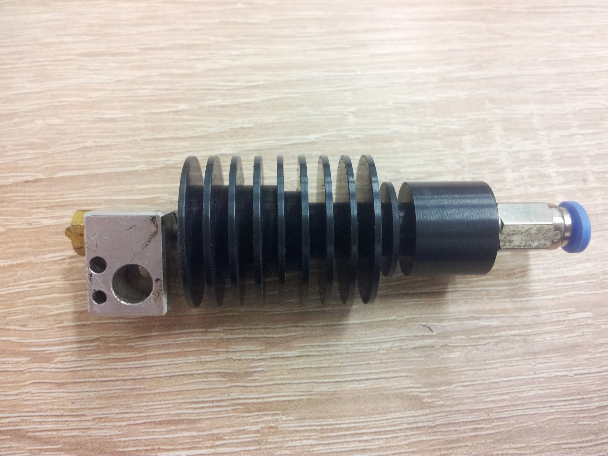

There has been some time ago since I talked about E3D fix, so here it is. It has to be said, its still untested. Working on so many exciting stuff at the moment, that I just cant find time to do all the tests. So basically all I did is I brought back the PTFE tube into the game and shorten the heat sink a little, just enough so tiny little bit of fan will be blowing trough the heat break. Its needed to say this is only gonna help out with PLA filament, with ABS stock E3D is really THE BEST out there! @Sanjay_Mortimer need to write you an email, was looking at the kraken, really really great job!

Love your custom black heat sink by the way. Did you anodise it or use some sort of chemical aluminium blacking solution?
@Sanjay_Mortimer its hard to describe, but with bowden setup and in cases with many short retractions, in case slicer wants to fill small gaps-circles-areas, there has been constant problems with almost like jamming issue. I think the melted/softened filament comes up to the heat sink area and start to stick to the wall. A fan trough the barrel (in that tiny 2mm or so spot between heater and heatsink) gets rid out of 90% of this issue, but not completly. Hope to have this piece of PFTE tube solving this completly.
Yes its anodizing, I have really great source for this, actually the company from whom I ordered two of these heatsinks organized also black bling-bling.
