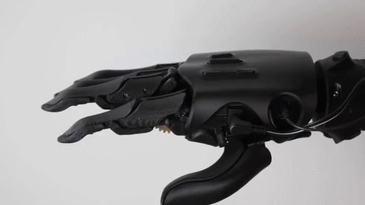

There is still time to get involved and help build Ryan’s prosthesis! We really need help from someone with experience of vacuum forming silicone!

I can look at this for hours, what and amazing bit of mechanical engineering.
