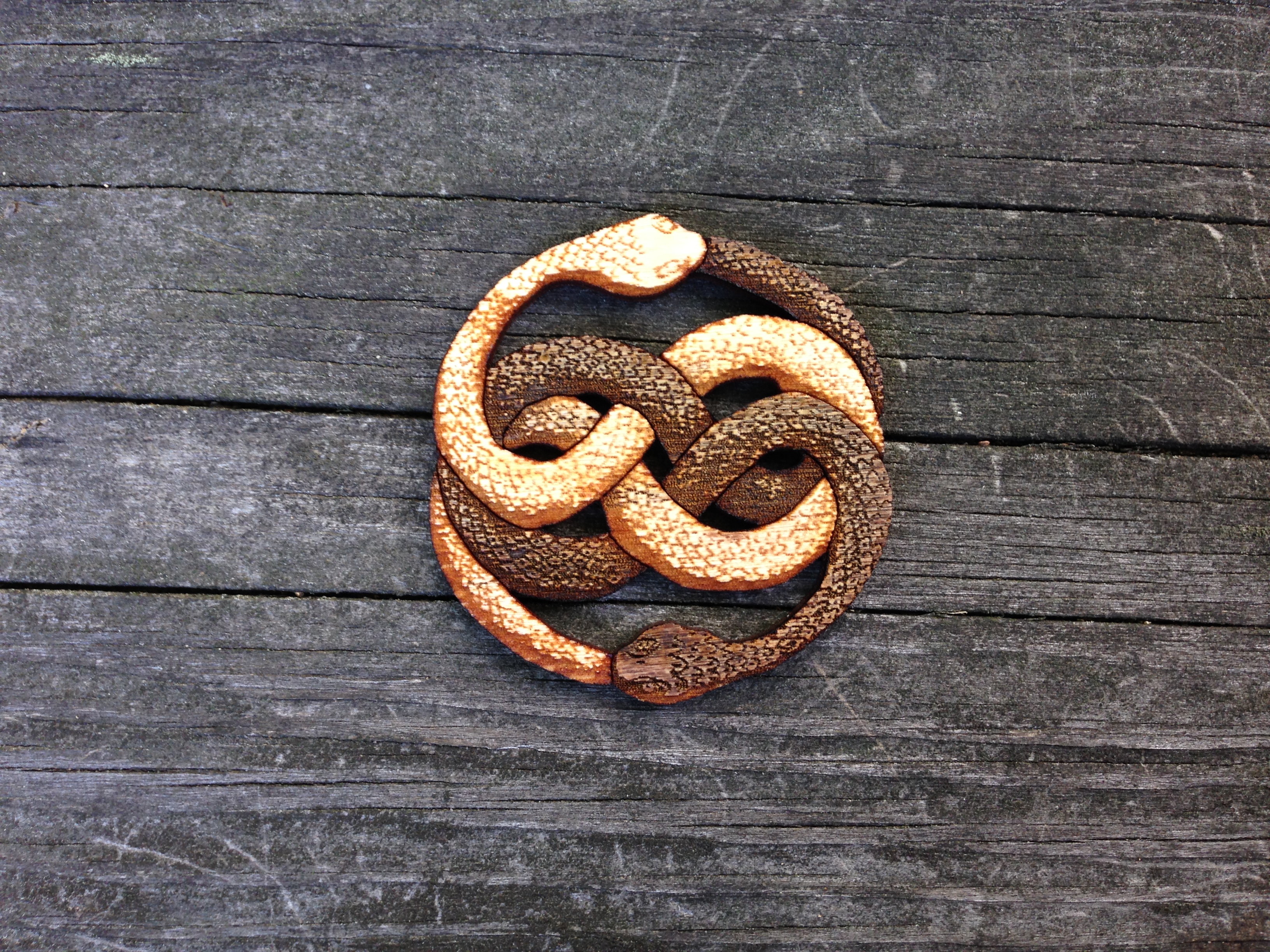

There’s a theatrical showing of The Neverending Story coming up, so I figured I’d make AURYN pins for my wife and I to wear to the movie.
Initially I just grabbed an image and etched it in a circle, but then I made a few iterations to refine it, adding a shape cutout and partial cuts to strengthen some lines. Then I used two stains and colored each snake with a q-tip.
Final version, 3 passes:
etch (engrave): 5mA @ 400mm/s
enhance (cut): 5mA @ 30mm/s
cut out: 9mA @ 10mm/s
Very nice 3D effect.
They look really cool. Did you paint them afterwards to get the two colour effect?
@Yuusuf_Sallahuddin_Y Yes. Well, not paint but 2 different color minwax stains, “Golden Pecan” and “Red Mahogany”.
@Tev_Kaber Gives it a beautiful effect. I like it :slight_smile:
They look awesome, you did a really nice job! What wood and thickness did you use?
@Jeff1 Thanks! It was 3mm birch plywood.
