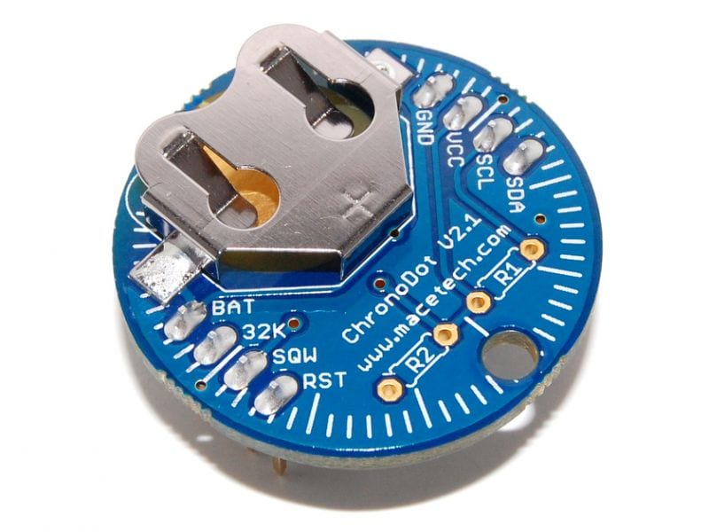

I suggest adding a battery backed RTC module. You’ll get more accurate time keeping and can use what you have already. Here are two Canadian sources for modules with the accurate DS3231:
http://www.robotshop.com/en/ds3231-real-time-clock-module.html
Also an article on DS3231 accuracy:
