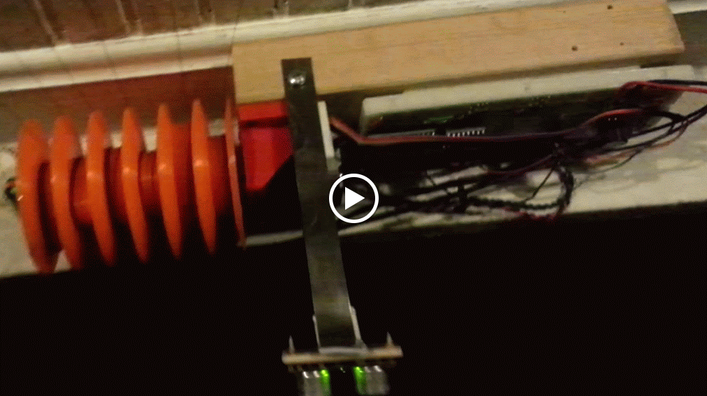

These lighted flexible black widow spiders drop from the porch ceiling when nefarious beings
These lighted flexible black widow spiders drop from the porch ceiling when nefarious beings come for candy.
It uses a Teensy 3.0 with Ultrasonic sensor to detect the little monsters.
This drives a Panucatt Stepper driver and a NEMA17 motor.
The power for the LEDs is carried to the spiders through magnet wire spider webs.

How do you get the power through the spools to the magnet wire. You have a wiper or brushes?
theres an18560 Li-Ion battery inside the spindle… it’s good for about 10 hours.

The pulleys have different diameters and shapes, so that each spider’s motion is slightly different from the the others.
The stepper motor motor is programmed with smooth acceleration. The spiders drop in 3 steps, then shoot rapidly back to the ceiling, It’s hard to see it in the shakey video, but you can hear it in the audio.

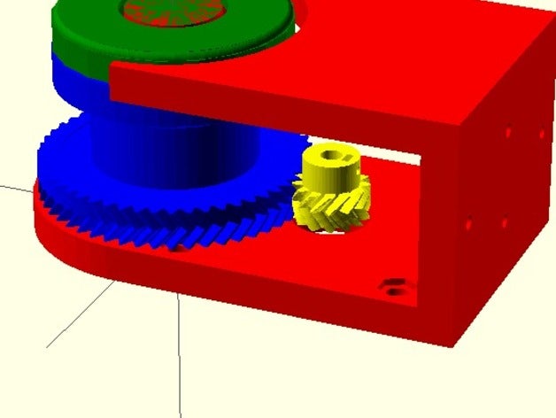

“Challenge Accepted!” LOL… I love that! Wish I could get my “heavy duty wire winch” printed… It’s close! Just missing the drive gear now:
