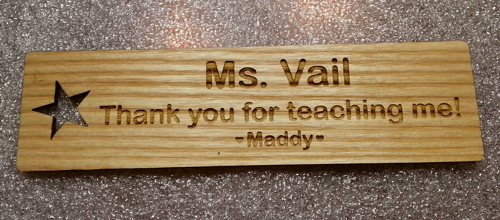

Alder is my go to for a lot of engraving. Cherry is also good. Maple, walnut, oak are fine as well but the contrast is lower if you aren’t using a darkening spray post engraving. The only one I recommend not using, if you are engraving, is ash as the spring and summer growth grain don’t laser evenly and it looks stripped.

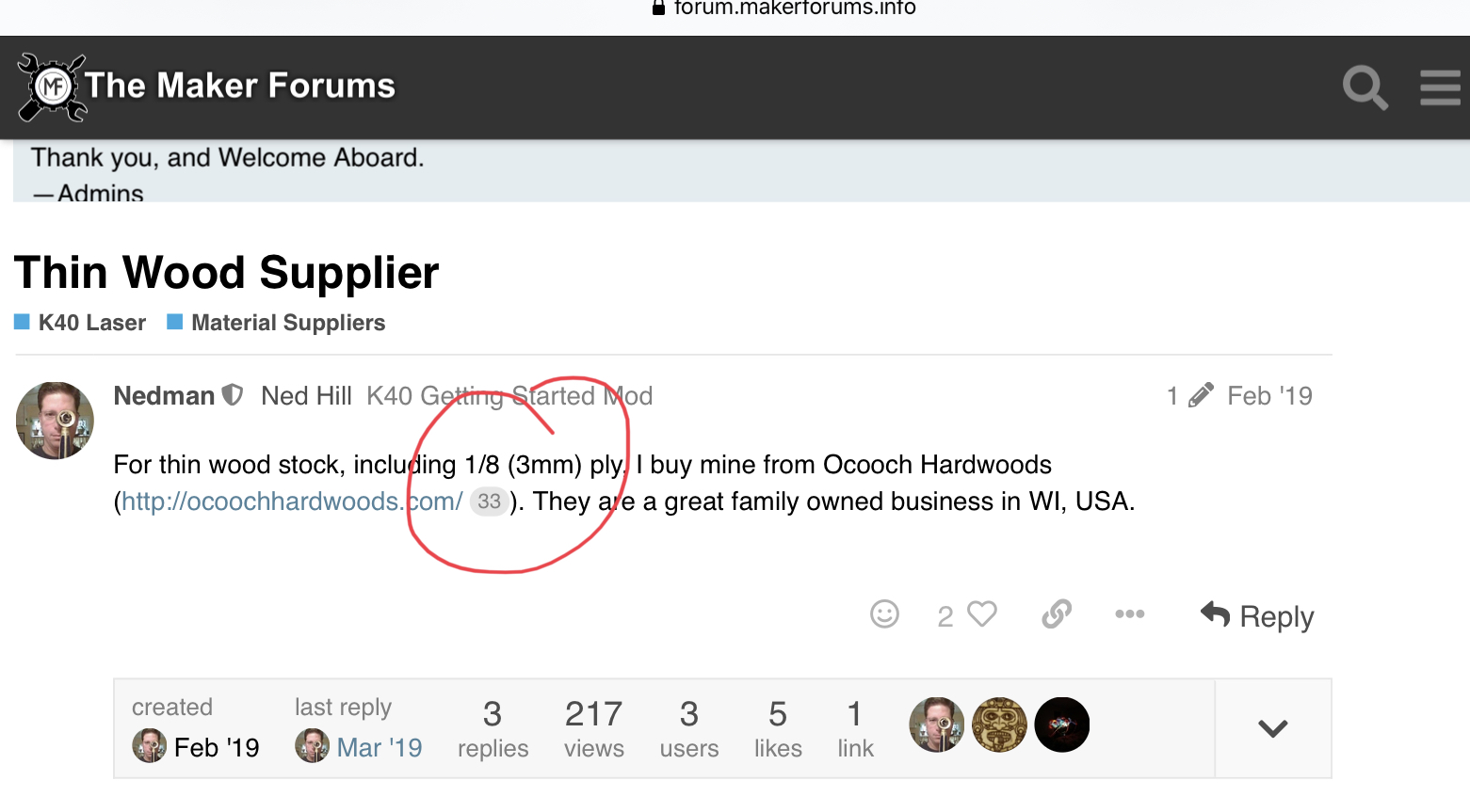

Thanks for the link. Thought you might like that my click turned the counter to
