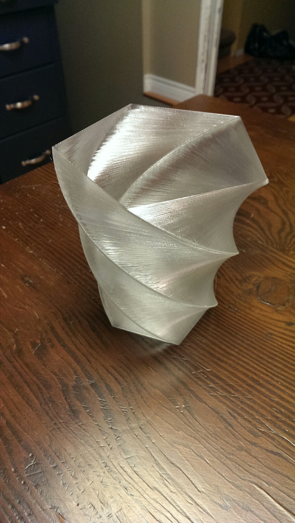

Thingiverse spiral vase. It's 150mm tall printed in PET from filaments.ca
Thingiverse spiral vase. It’s 150mm tall printed in PET from http://filaments.ca
PET is known for shrinking when heated. Any tricks to printing with this?
Print Slow. It shrinks when it cools. I have my fan on 60%, and run the Exxtruder around 230, and the bed is at 75 with gluestick treating the bed. Like 10mm/sec slow.
