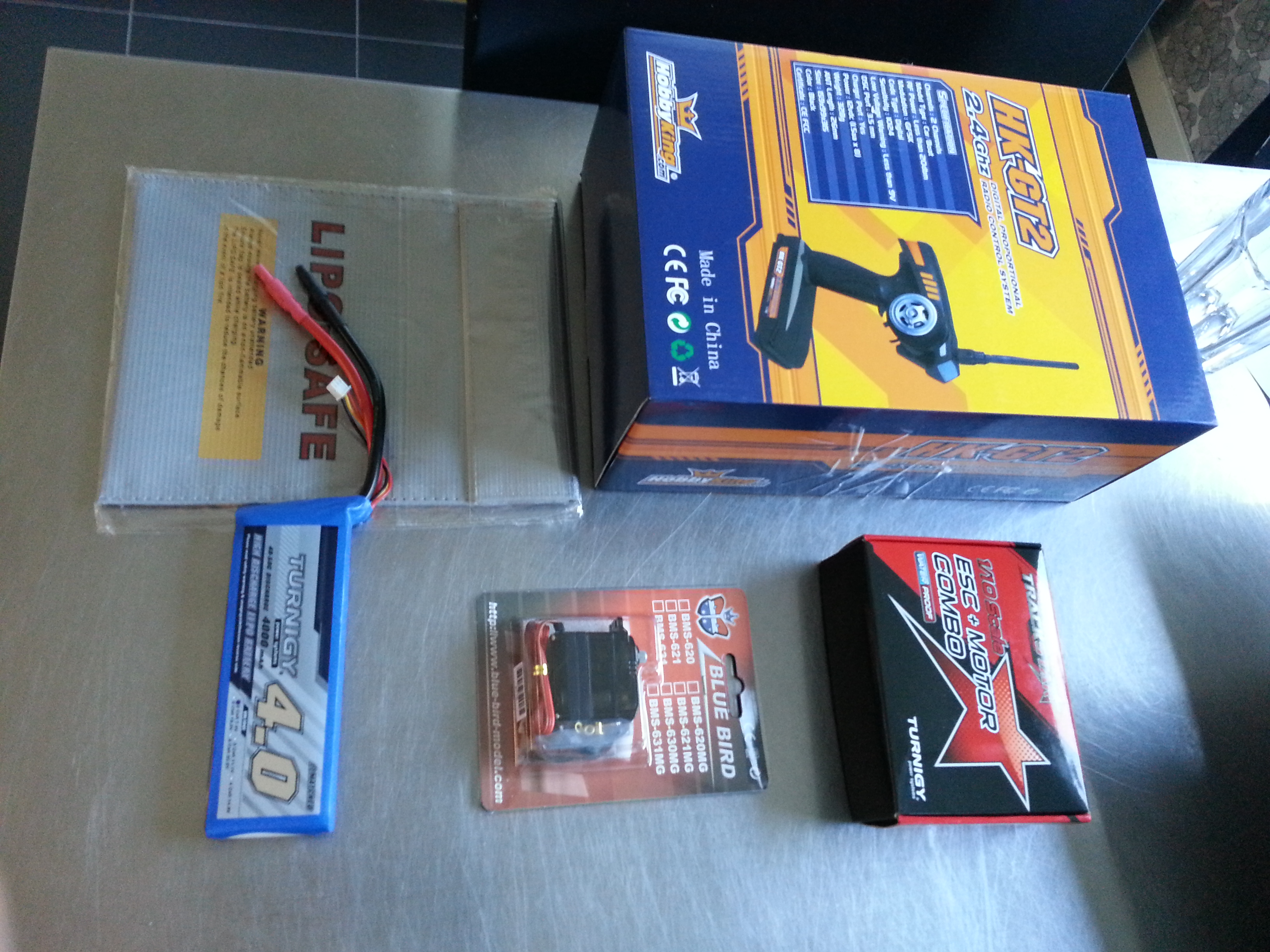

Things are coming together…
3000 kV will be fine. The 4000 kV motor will spin 33% faster given the same voltage. You can make up for the difference by changing for a larger pinion on the motor.
@Daniel_Noree looking good! Are you planning on using these with an all-printed drivetrain?

I’m also have this motor combo waiting for me at the post office:)
