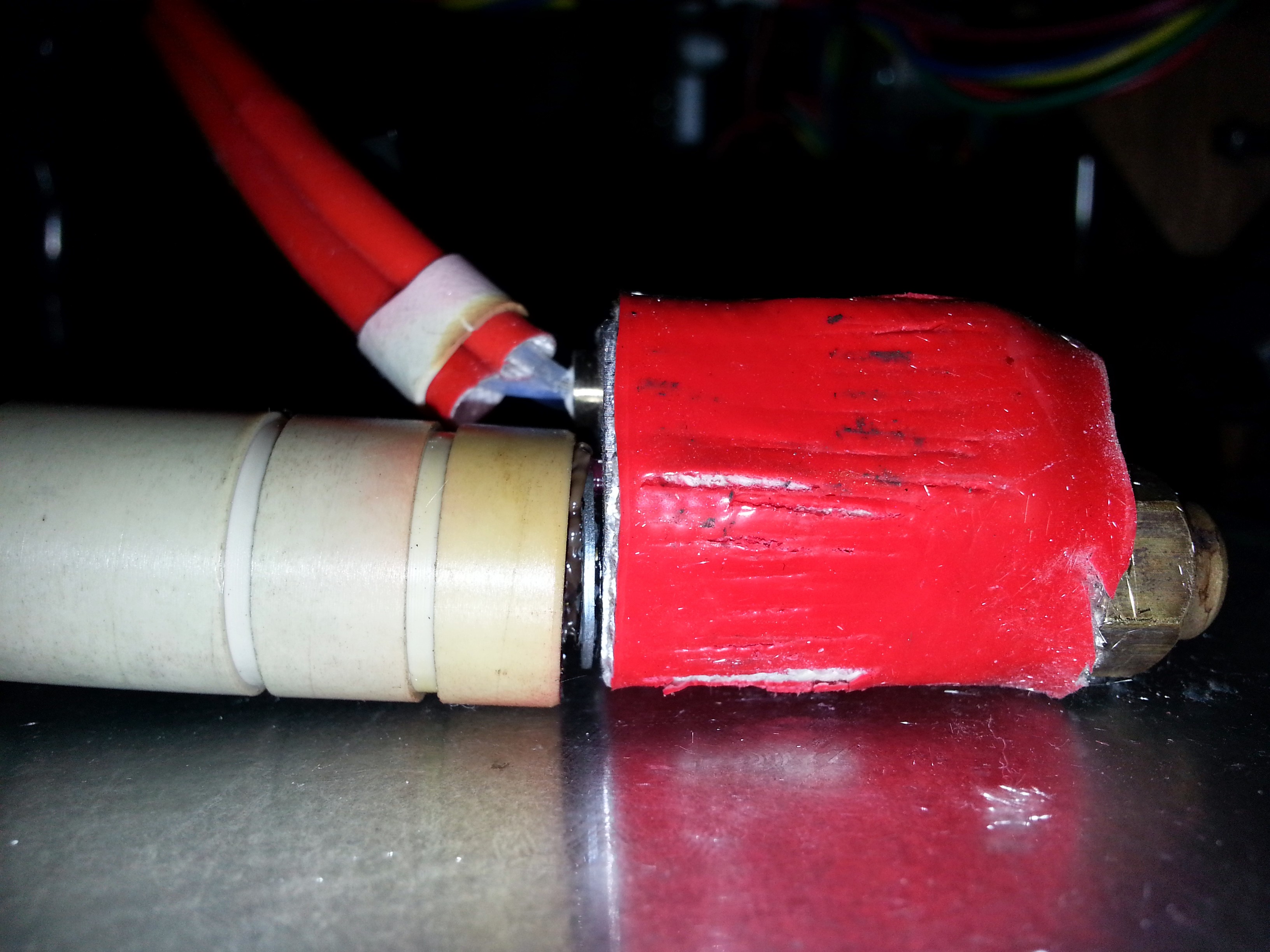

Things were really starting to go well, but then!.. My @Printrbot hotend overheated the other night during an unattended print. Does anyone think it can be repaired after this kind of damage?
you can get a new peek block, the rest should be okay :slight_smile:
Hmmm, i already took some pliers to it trying to break the PEEK insulator away from the rest, but no luck. I did just opened a support ticket with @Printrbot so I might wait to see what they say.
You really need to determine the root cause of the failure. You probably have a faulty thermistor connection, as the firmware should not allow the hotend to overheat otherwise. Given that this is a dangerous failure mode, especially when unattended, this really should be fixed prior to ever leaving it unattended again. Good luck, and be safe :slight_smile:
My thermistor’s wire snapped from fatigue (poorly anchored) and it shutdown the printer (Simple 2014).
Bummer! Any clue as to what went wrong?
My only thought is that there was/is some sort of electrical problem causing an erroneous reading. I was able to do more printing after this happened, although the quality wasn’t good, it hasn’t shown any more signs of overheating.
I ordered some replacement parts from QUBD so I should be up and running soon… Just in time do do all the mods I’m designing!
