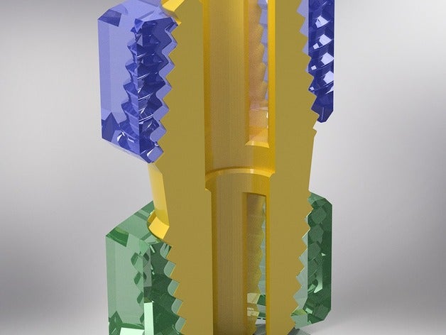

I built my own i3 a few months ago, I used these self-centering z-couplers (http://www.thingiverse.com/thing:602481) while waiting for some metal ones from China for $0.99 to arrive. They work so well I’ve not got round to replacing them yet
