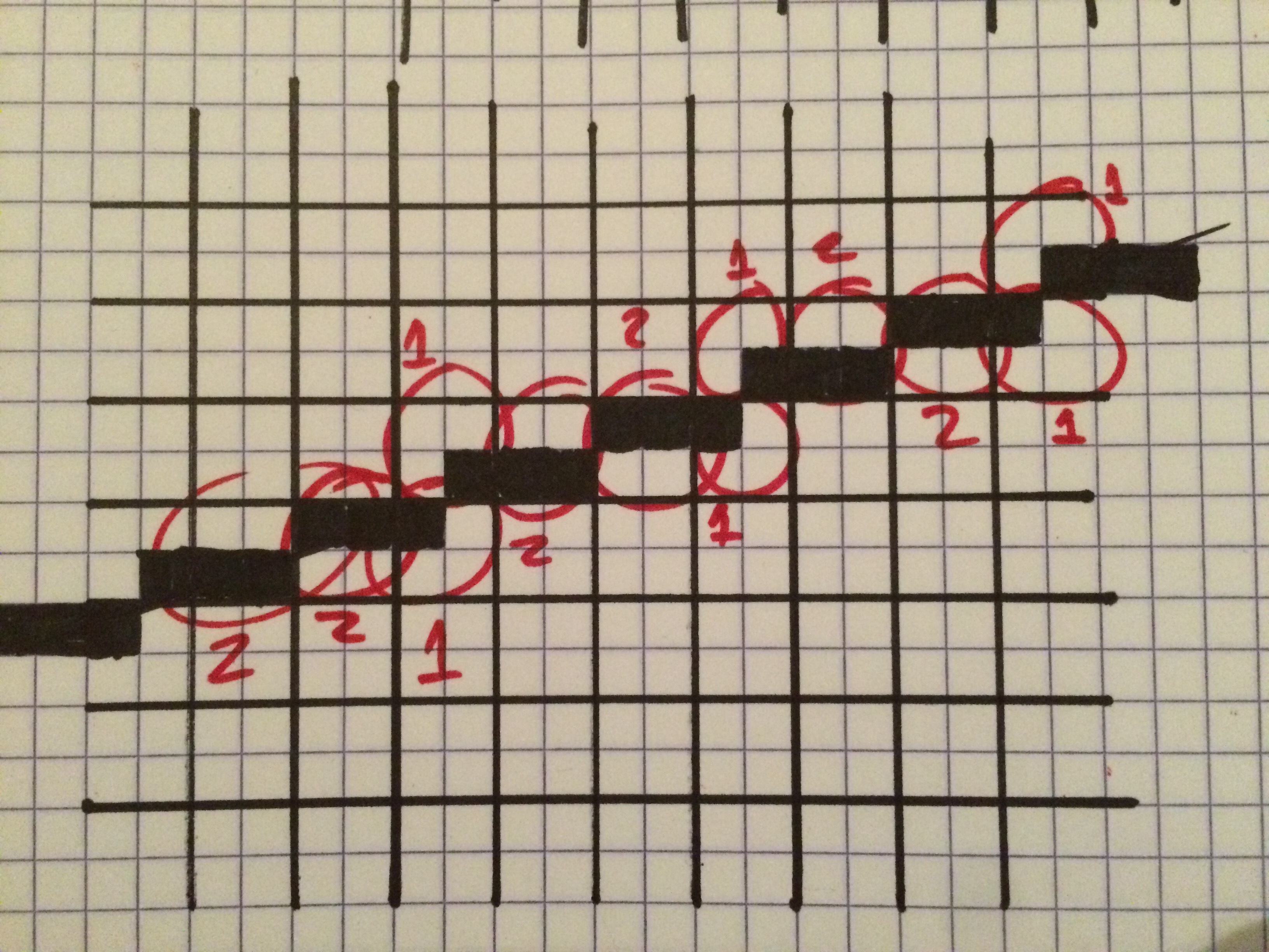

Thinking about scaling code, and how you would render into a higher resolution buffer,
Thinking about scaling code, and how you would render into a higher resolution buffer, but then map that back to a lower resolution pixel grid.
A while ago @Mark_Kriegsman posted an example of how this was done in 1-D, and I understood it and could adapt the code pretty easily. Basically you use n of the most significant bits of your x value as the pixel address, and the remaining m as the brightness of the adjacent pixel.
But my mental model broke down when I tried to move into 2-D. What do the pros call this, and has anyone got some simple example code?
(I think I’ve got the idea in theory, as illustrated—the real pixels with 1 “sub pixel” lit get 1/4 brightness in my example, those with 2, 1/2) but I’m not sure how that translates in practice. is it simply enough to logical AND the “fractional” parts of each x and y pixel address to get the brightness for that pixel?)

Because I’m not sure if the scaling function you’re pointing to there quite does what I want?
It’s not just lines I want to scale/antialias—it’s points and dots. Actually, I think sprites really. Explain to me what the x1, y1, x2, y2 inputs to your MapNoiseToRectangle() function actually represent?
