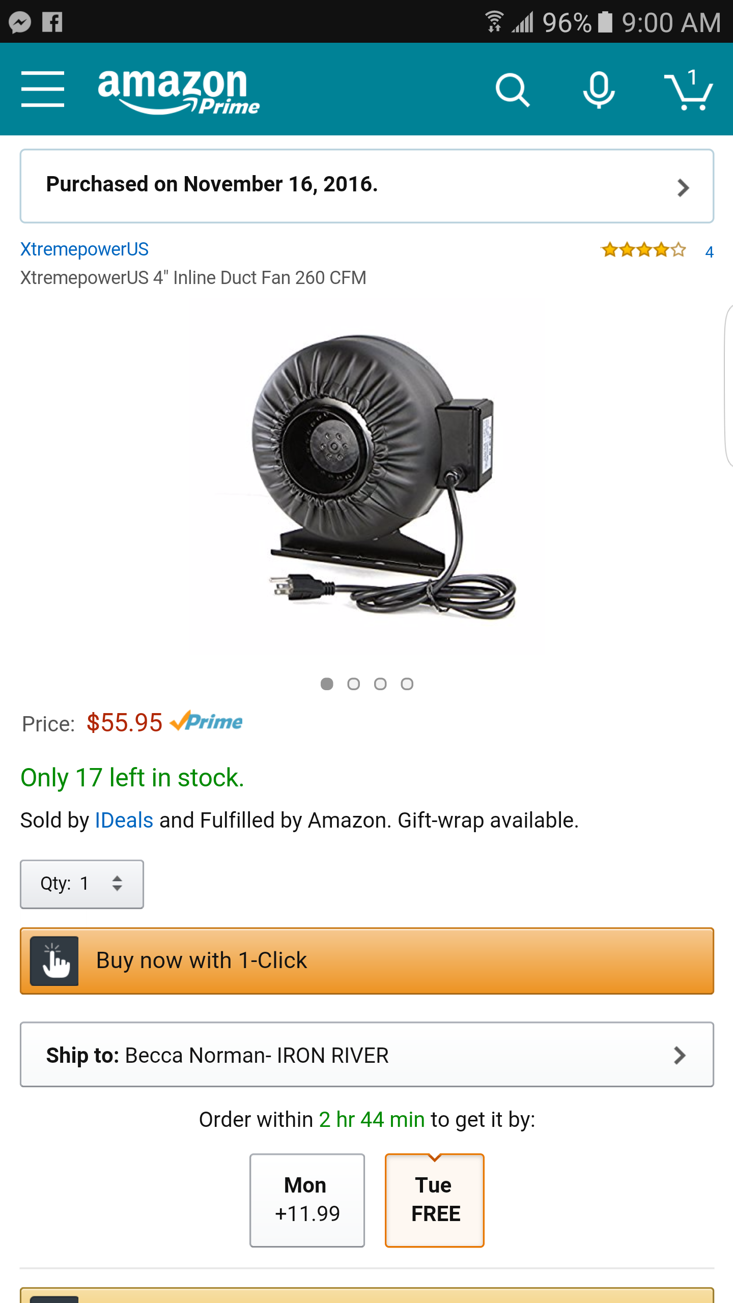

I have the 4" version. It does just over 200 CFM and provides good ventilation. It’s very quiet and came with a variable speed controller. I also have a 6" version installed for one of the A/C ducts. It’s also quiet but I had to get a separate variable speed controller.
@Niels_Sorensen do you have a link? The one I just saw on Amazon doesn’t have the speed controller.

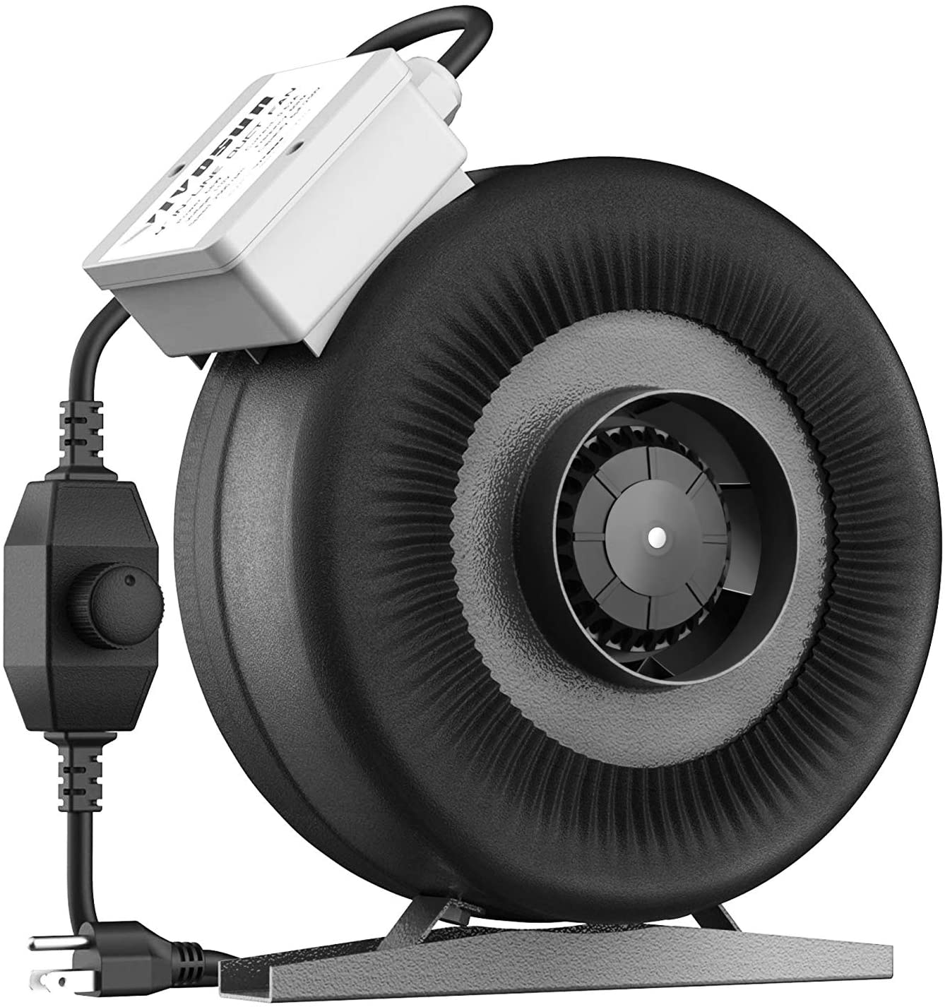

It looks like both the 4" and 6" have the variable speed now
Just got this one in the mail yesterday, it works really well.
