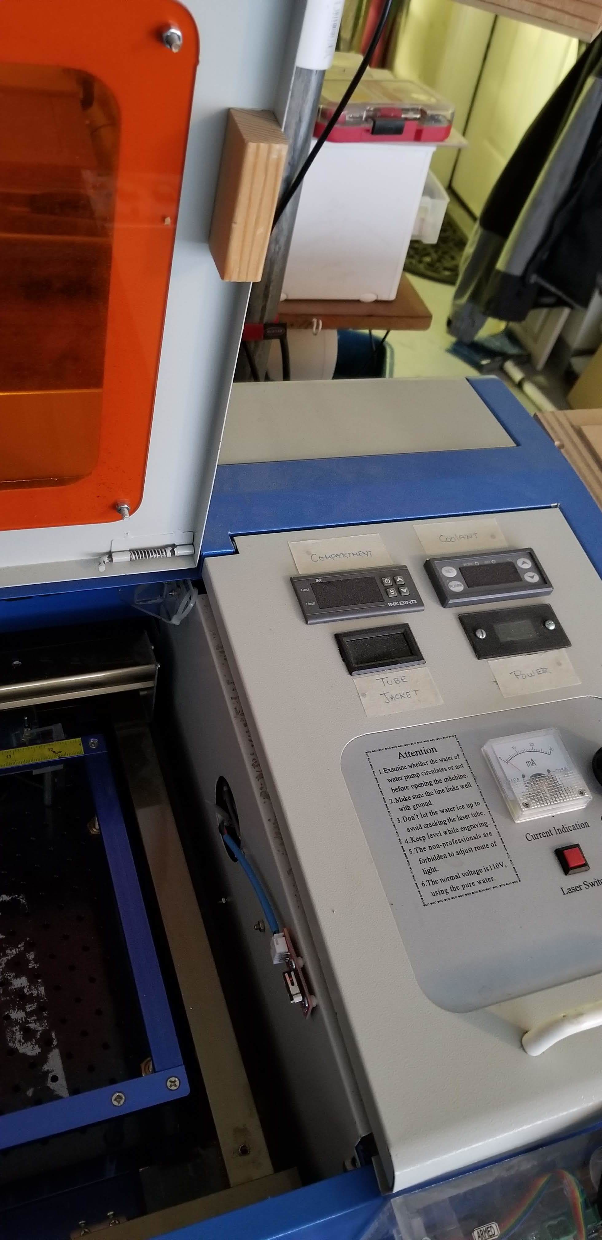

Yep, here is my simple door switch:

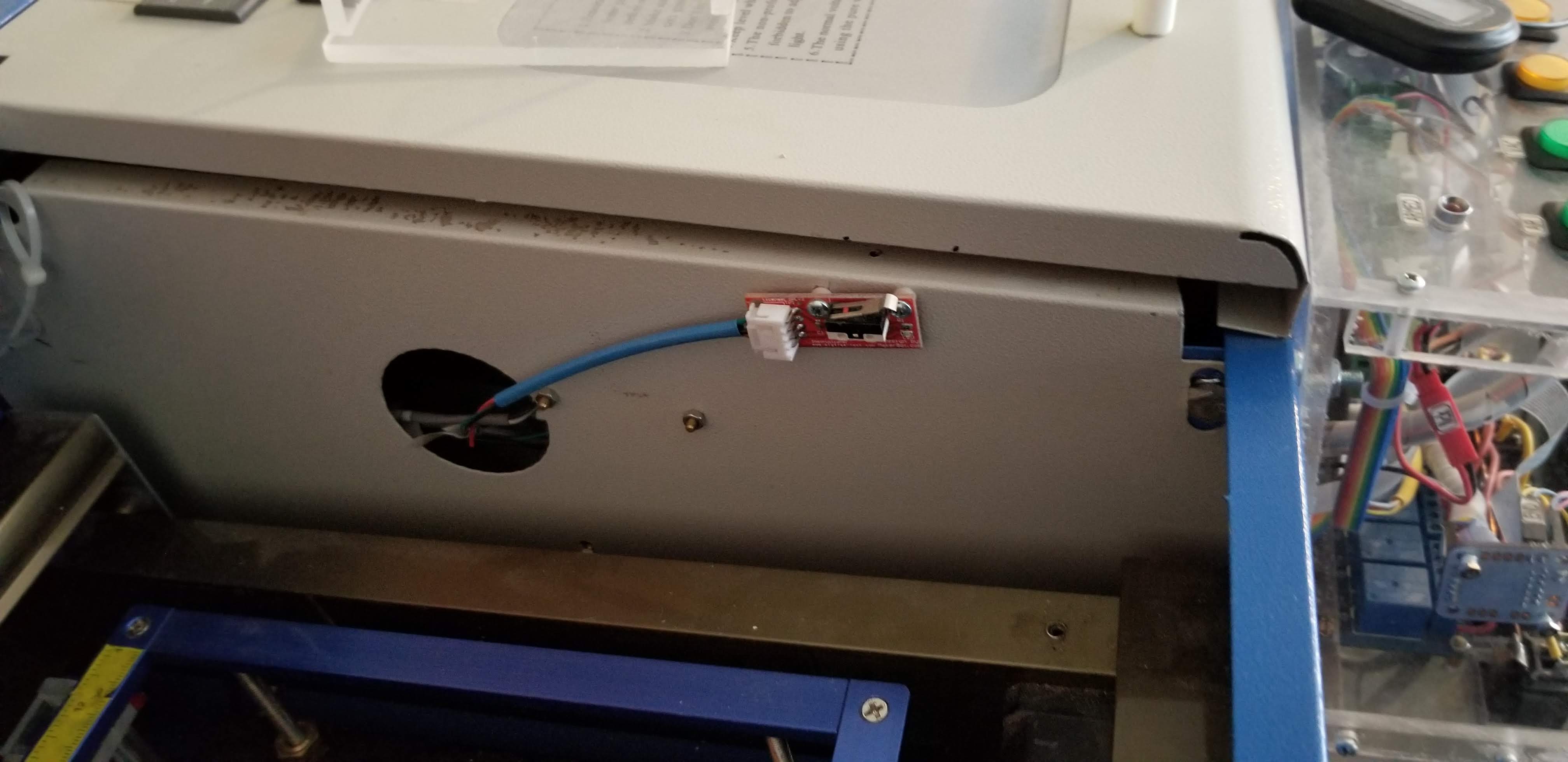

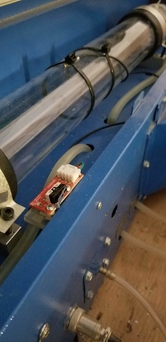

These machines should not be run without interlocks installed and the covers closed.
Imagine what your retina would look like if even a portion of the beam hit it.
Its not rational to protect your laser tube (temp & flow sensor) but not your eyes and body from eye damage and electrocution!
Since the beam and the presence of HV are both invisible accidents can easily happen.
PLEASE: You are NOT SAFE unless you have interlocks on the covers front and back and use them.
I used some switch modules from Amazon that made mounting and wiring easy.
