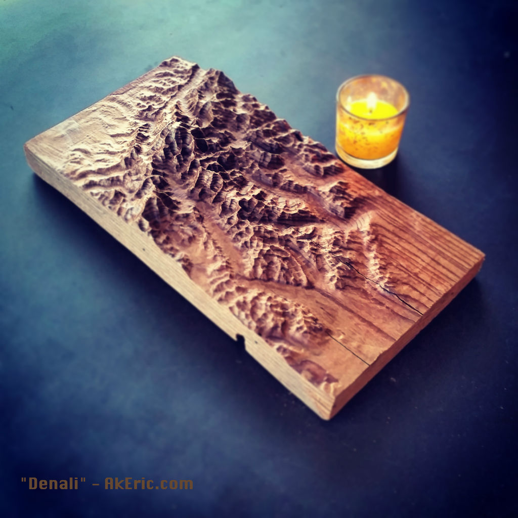

This “bug” has happened to me before, but not in a while: Last night while cutting the piece in the attached image (2.5"x6"x12"), the cut would constantly pause. I’m using GRBL with an X-Carve. The rough cut was 1.5 hours, and had no problem/pause. But when the final pass started (same bit, no change/pause), it got maybe 1/8th the way through (just milling back and forth on X) when it would pause. I’d press the ‘~’ button and it would resume. It would go on to do this maybe 15-20 more times over the next 3 hours. It’s obviously super disconcerting to have your cut constantly stopping.
The gcode is 4.6 megs… doesn’t seem too crazy? I was running it at 90ipm… would this have anything to do with it? It has having no trouble a that speed, I could probably go faster (technically).
Any thoughts appreciated!
I dunno about the bug but that is one lovely piece of cnc machining!
@John_Bump : Thanks, appreciated!

@Eric_Pavey very nice piece nevertheless !
