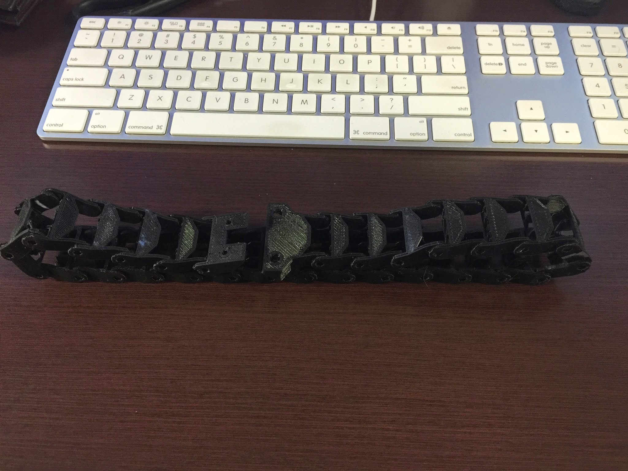

This cable chain was in the HercuLien printable stl files.
This cable chain was in the HercuLien printable stl files. Does it actually get used somewhere? If it does, I have no idea how many links need printed, but I was having fun printing them.
It’s for the heated bed cables it’s not necessary but I believe you need 22-26 links
It is for the heated bed power and thermistor leads. I printed one of each end and 20 links. Mines a little long so you could probably get by with 18

Also you alternate the direction the links are connected every other one.
@Eclsnowman Oh yeah you can alternate them!! Thanks.
