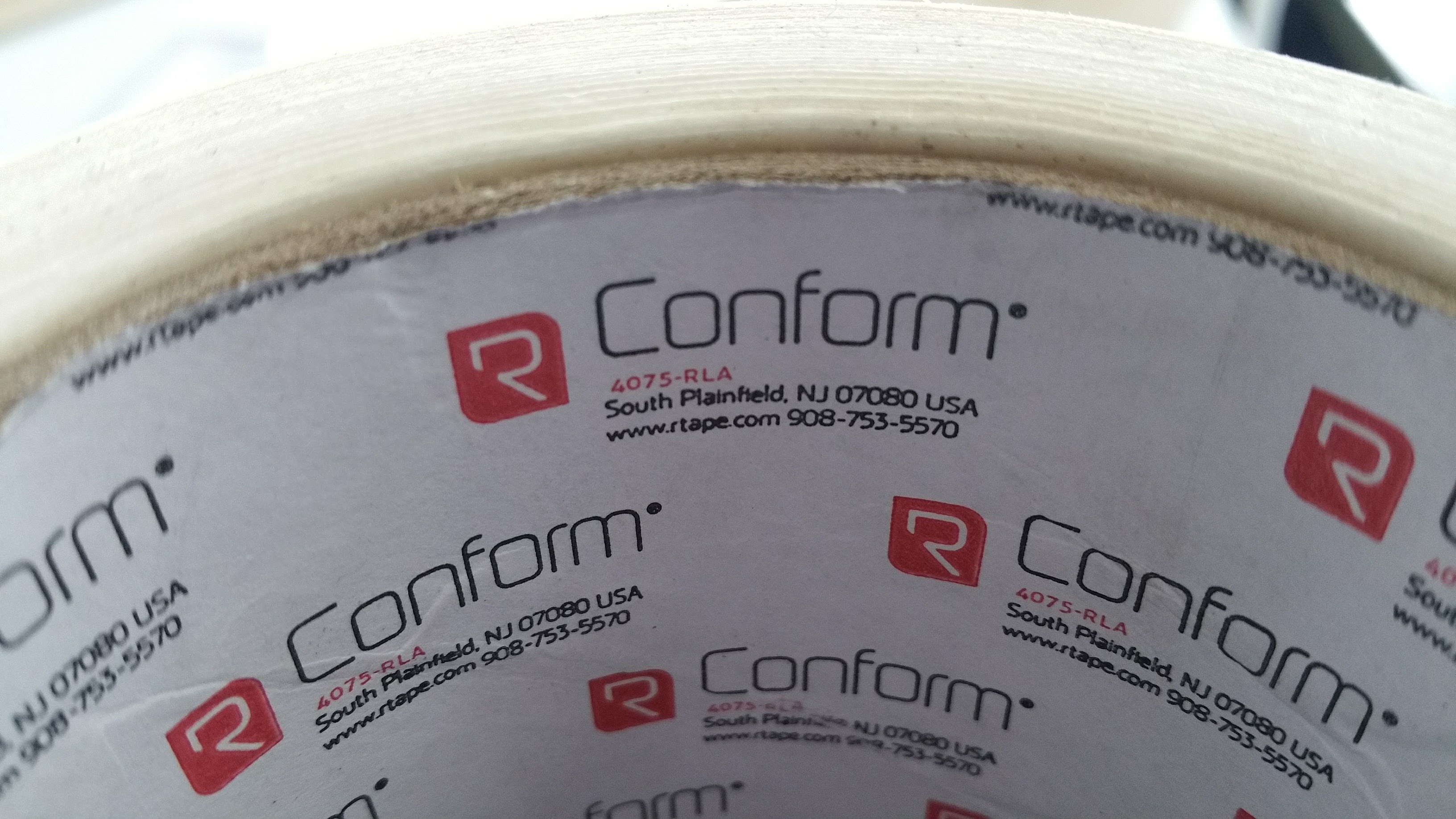

For my wood cutting/engraving, I use RTape Conform 4075RLA which is a high tack paper application tape. A while ago I posted a picture of how I mask a bunch of material in one pass. This stuff sticks well to Birch wood that I work with. Usually a single pressure pass on the roller is enough, but occasionally, I will run a 4in squeegee over it by hand and press down a bit harder. If I do it too much, when I lift the tape up, it will take a very minute amount of fiber with it, enough to make the surface a bit rough. Some times it actually results in a nice rough finish, though generally I will sand the finished pieces smooth.
