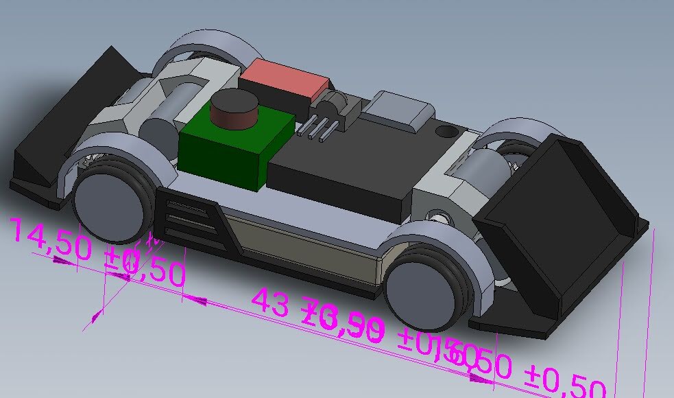

This days I’m drawing a ir rc 1:64 car. Still trying to fit all inside the body. It will have a attiny85 board, a 3,7 - 5,0 v converter a H-bridge, a IR sensor and a 350 mah lipo. All inside 75 mm lenght. Direction will be more like a tank. Lets see how it ends up…

Maybe its not clear on this rendering, but I’m planning to have one motor for each wheel and independent speed control for the left and right wheels. Thats why I say the steering will be something like a tank. I will try to make it as fast as possible and dress it in a sports car outfit, thow.
