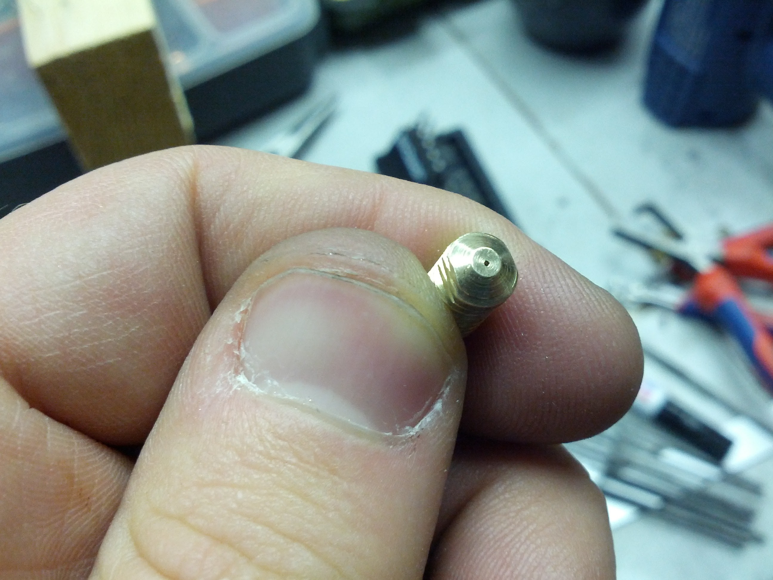

Emergency nozzle done. It’s a rather flat (as opposed to pointy) shape, which gives me nice, smooth surfaces, but it seems to have a bit more lag than the original one.
The nozzle’s bore is 0.35mm, since that’s the smallest size drill i had at hand (i mean, who doesn’t have 0.35mm carbide drills sitting around ;-). By the way, the bore looks pretty ugly if you zoom in, but really, it’s round.
@Sanjay_Mortimer the drawings of the E3D nozzle lack a measurement that tells how deep the large bore goes into the nozzle - that’s the same measurement that would have told me in the first place that’s it’s probably not a good idea to turn down the nozzle further. Can you add a cutaway view to the nozzle’s drawing?

@Thomas_Sanladerer All the nozzles adhere to the same basic rule, whereby the small diameter section is 2.5*SmallDiameter.
The remaining section is drilled to 2mm or 3.2mm depending on filament diameter.
So in the case of the 0.4mm default nozzle there is a 1mm long extrusion orifice.

So, i do own a couple calipers, but honestly, there was not much that they could have assisted me with. The original nozzle was ruined as is, so i didn’t have much of a choice but to try and get it back into shape - which failed, obviously.
