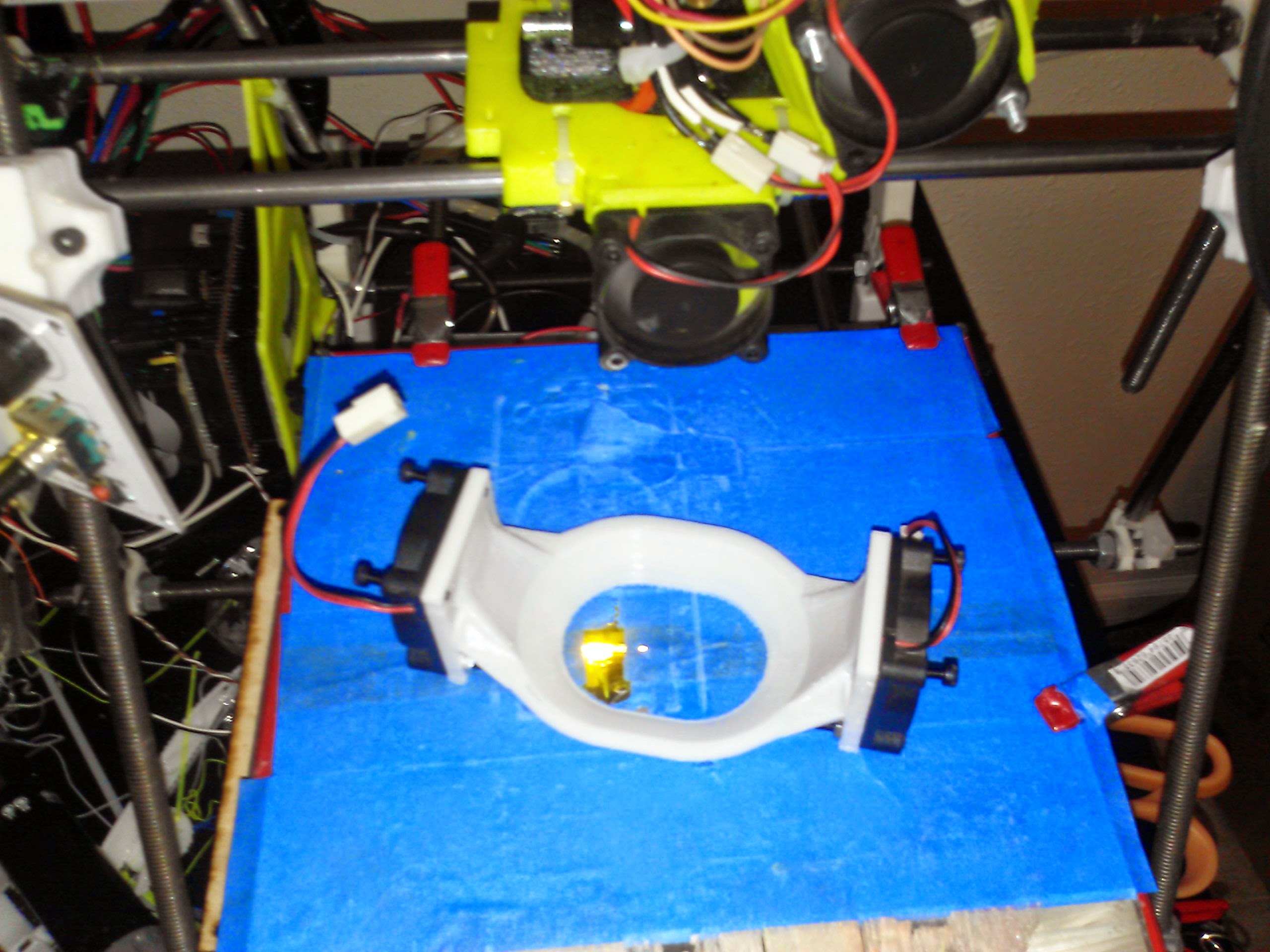

This extruder/x-carriage has turned into a monster eating up 75mm of my x-axis print space.
I just added the dual fan duct to cool pla parts and what not. We eill see how well it works.

Thingiverse link?
here ya go.
http://www.thingiverse.com/thing:31021
its a nice x carriage its just big
I meant the link to the dual fan duct
Its in the files on that thingiverse link, I think its name is wentylator_v2.stl
Are you sure? It doesn’t look like the one in the image.
I’m sure, he dosnt show it very well. But yes its the one.
Can you let us know how that duct performs? 2 fans should ensure cooling is nice and even.
My slicer profile put a raft under the fan duct so I have yo sand the first layer, otherwise with the raft layer it rubs the build plate. Not to mention I have a short hot end
Ill let you know how it goes.
@Jeremy_G_WeisTek_Eng I also can’t find a link to the fan duct - also searched for ‘wentylator’ in thingiverse with no success.
If you go to that thing, hit download this thing. It will be in the list of files.
Let me double check he didn’t remove it or update it
@Tim_Rastall @Thomas_T_Sorensen He removed it but luckily I have it
There ya go.
Sweet - Cheers Jeremy
Not a problem. I’ve found it can be quite finicky to print with abs. I’m on my third go around right now of printing it.
