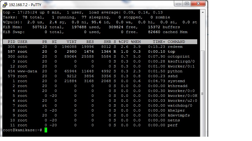

However, for you http://192.168.7.2:5000 sould work, as you are able to connect to the BBB via USB, right? At least your putty screenshot is showing this ip address.
