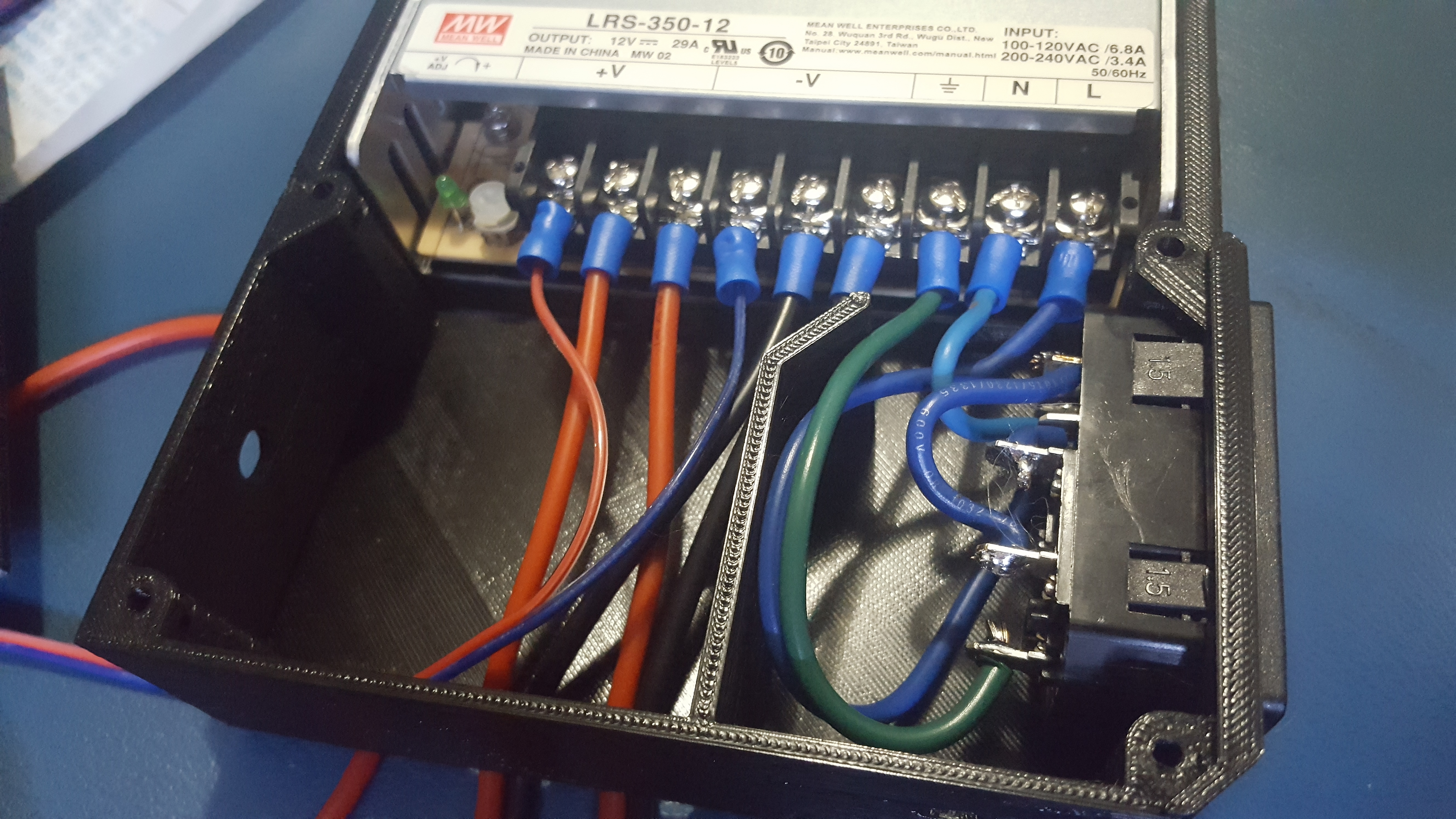

I used too hate running wires, but now that I have all of the necessary crimping tools it’s much better
I hate the open concept on the RAMBo mount but it makes maintenance so much easier lol. Now i just need to manage the wires a little better :slight_smile:
