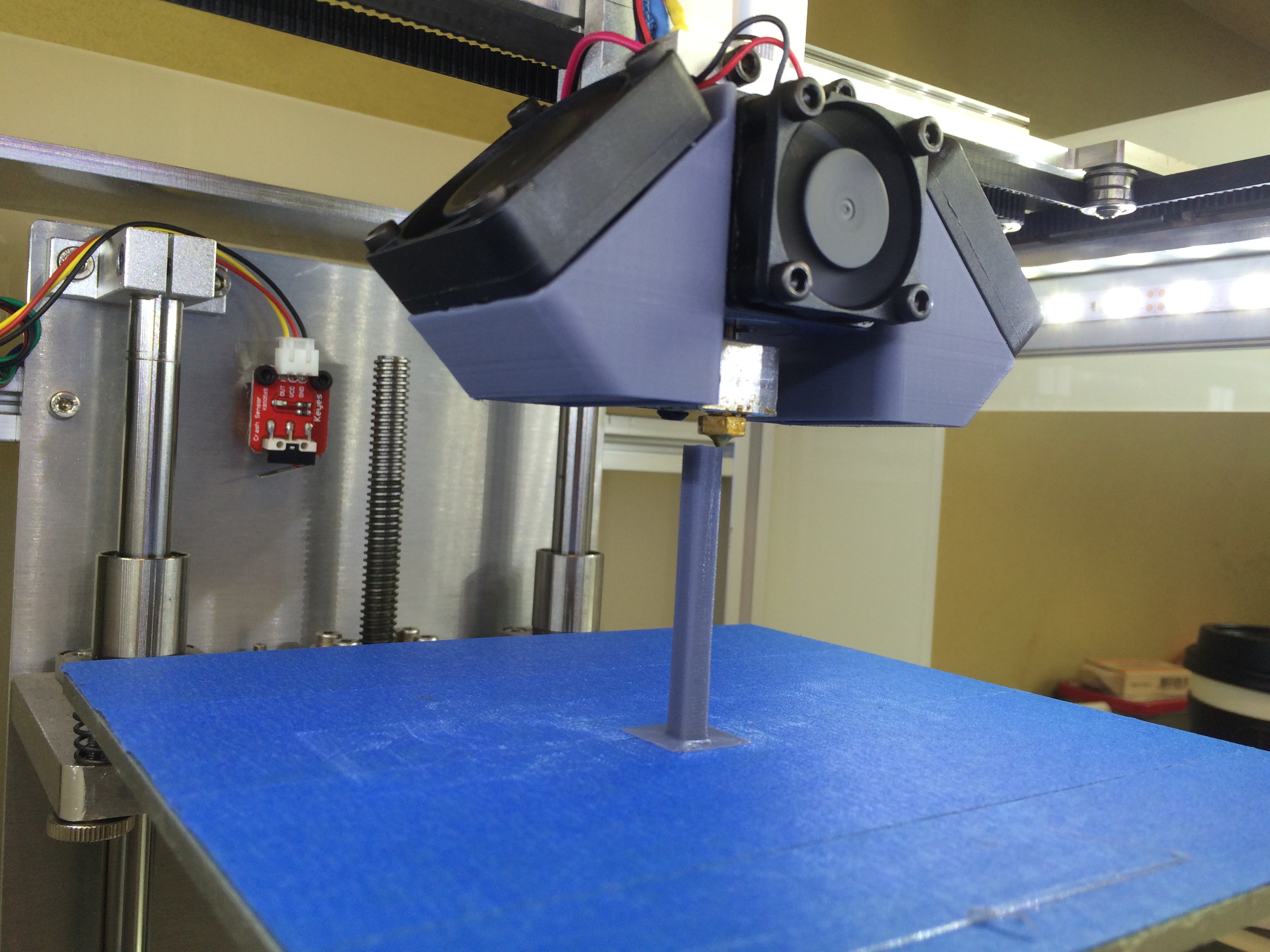

This is 3rd or 4th design of fan duct for E3D v6.
I tried to solve asymmetric air flow using one 40mm fan attached one side, but failed.
At last I decided to go dual fan duct, and turned out to be good choice.
It shows best performance by far.
It can be printed in one piece.
If you interested in this model, you can download it
-> http://www.thingiverse.com/thing:1292038

@Joe_Spanier It is MSC9 series from China, 10mm height
@Griffin_Paquette Thank you!! I still want to improve mine to commercial level printers. And It might be too early but Hbot can be good as Corexy if use linear rail & tight belt

@borislav_bozanic Thank you, It is my DIY designed printer. It is Hbot
I’ve made an air duct using one 50mm fan. Works like a charm. I guess it depends on how you wanted to redirect the air.
Looking good @DongWon_Han_DWONH
I wraped the end of my nozzle with ceramic wool I got from qubd holding on the nozzle with kapton tape.
That way, I can direct airflow directly at the very tip of the hotends and that way, I have an easier time with long bridges…
