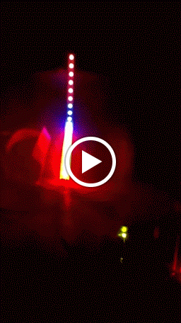

This is a follow up to my previous VU video post. https://plus.google.com/105445034001275025240/posts/jK2fxRx79kj
It’s really quite amazing how simply adding nscale8(), twice, can change your animations substantially. In the video, I use the nscale8_video() which never lets your array fade all the way to black.
The best part that I just cannot capture with my sh#tty camera, is I have a single pot to dial in certain variables while a push button, saves the pot setting and then scrolls thru a preset list. Pretty simple, and easier to code than I thought.
How come some “beats” are hitting leds[max] and others aren’t? Are you doing that on purpose?
I originally took code from Adafruit’s LED tie project. It has a feature where it scales the visual output to the size of your LEDs. I’m still experimenting with and tweaking the code. It could be my mic breakout too.
Here’s a different vid of the same thing at full brightness with diffuser, you can see the effect of the falling peak better: https://www.youtube.com/watch?v=JjX8X5D8RW0&feature=youtu.be

@Ashley_M_Kirchner_No The mic has an AGC, meaning Auto Gain Control. Duh, so after changing the attack response, it looks even better. RTFM!
