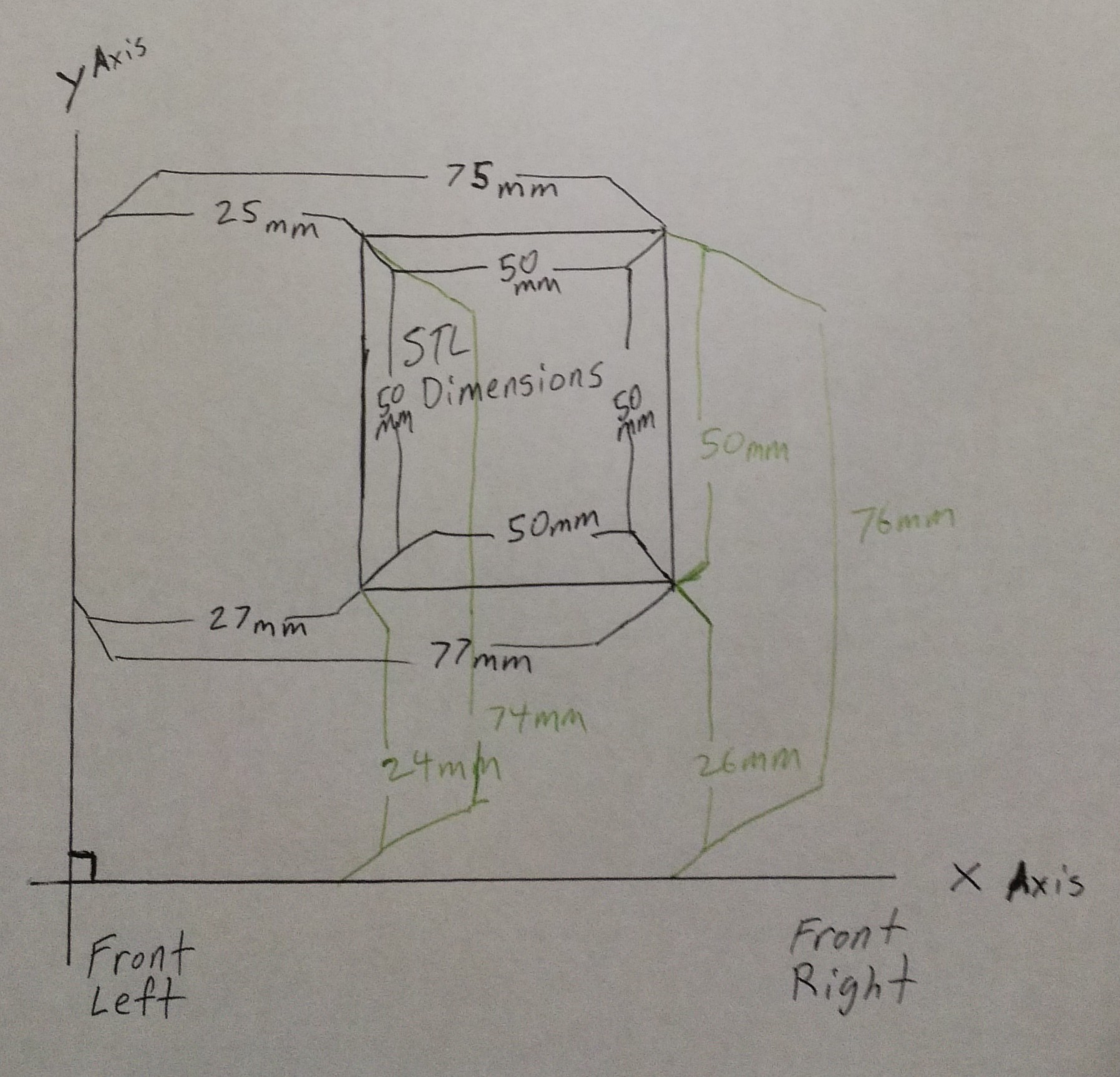

This is a problem I am having.
This is a problem I am having. My squares are parallelograms and my circles are ovals. Isn’t this fixed by using the skew settings? How do you figure out how to set the skew to the right setting?

  1. Just to verify… you’re not just measuring from the build plate edge, right? The build plate might just be crooked against the gantry.
  2. I would look at mechanical alignment of your printer before trying to do skew correction. Skew correction itself can introduce print flaws.
@Ryan_Carlyle ​​ no I am not measuring from the edge of the build plate. This is just an example of possible deviations in the squareness x and y axis. Looking for a good way to fix this.
As for fixing the mechanical alignment for this printer would be a serious pain. The way it is assembled makes this almost impossible. In case you are wondering, it’s a M3D micro.
Ryan Carlyle is correct. I’ve set up machine tools for a living in a past life. Your x and y are not perpendicular. You may be able to fix it in software, but fixing the alignment is a better option if at all possible.
