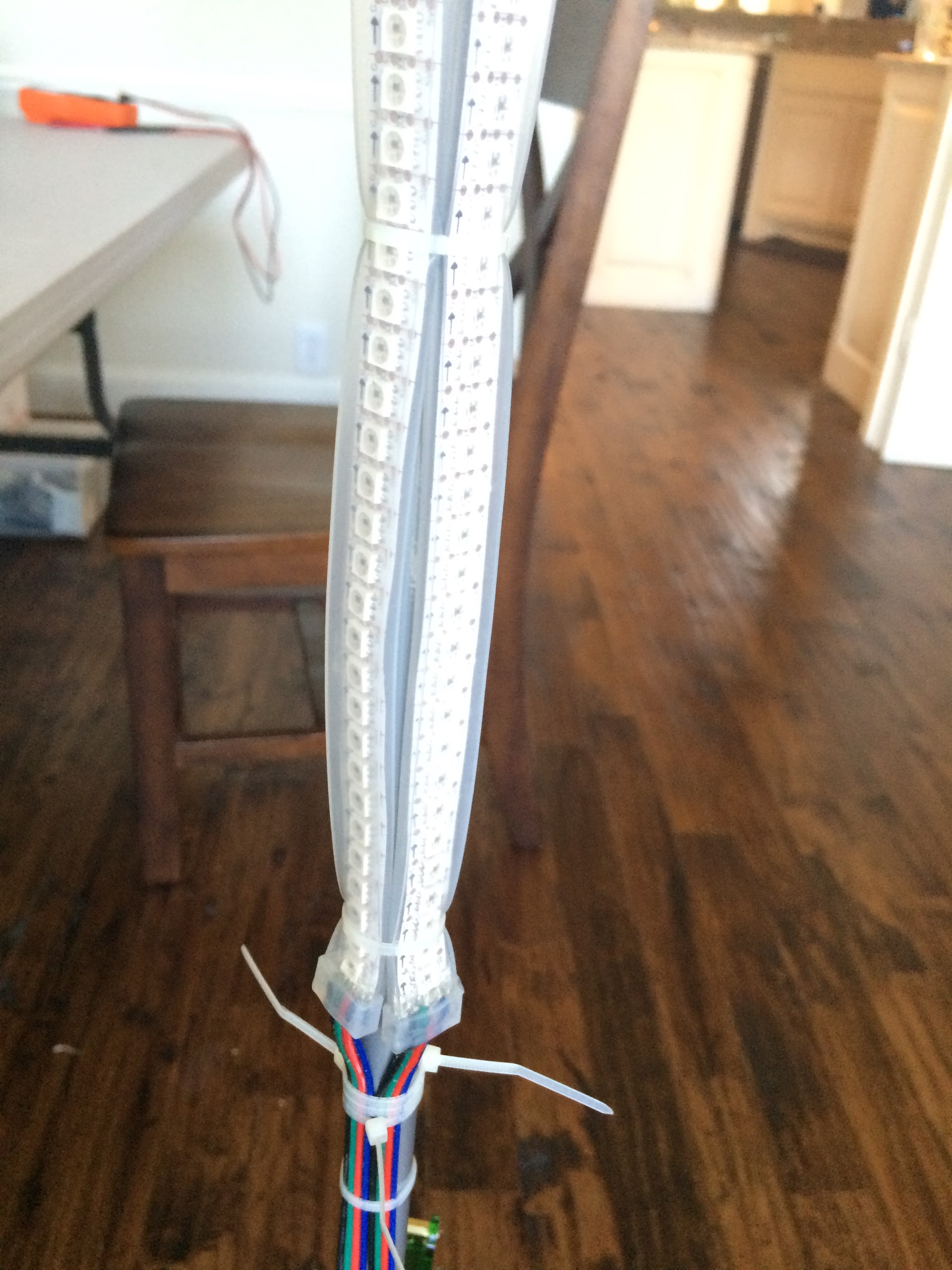

This is an APA102 floor lamp powered by a single Uno R3.
This is an APA102 floor lamp powered by a single Uno R3. Posting these pics of the strips mounted to the pole by request.
Thanks for showing “behind the scenes”.
Humm, nice setup, It’s a bit different and easier than what I had thought. It’s one of the most interesting uses of addressable LEDs I’ve seen. Good job Michael! and thanks again.
Sure thing. Good luck!
Do you have three strips around the stick there, or just two?
Just two. There is room for 3, but that ups the power requirements. This setup runs off a single 5v, 10A laptop style PS and even so, I had to adjust the brightness settings so as not to overdraw. If you added more power, one could add maybe 2 more strips.
Yeah, you’re using the 144/m strips. I ask because I’m doing due diligence on a similar arrangement that I want visible 360° around a shaft, and the 5050s nominal viewing angle is 120°, so…
Ah! Cool. Makes sense.
