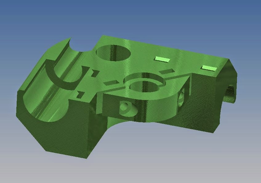

This is an update to the xy carriage of the Motedis QR 500 3d printer i made some time ago.
This carriage is a bit larger than the previous one, so the bearings are further apart which makes it more stable. It is also possible to mount a fan to it which is needed to get good quality PLA prints.
The fan trunk and radialfan adaptor fit tight into the big hole in the “lageblock”. If printed correctly you dont need any glue to assemble.
