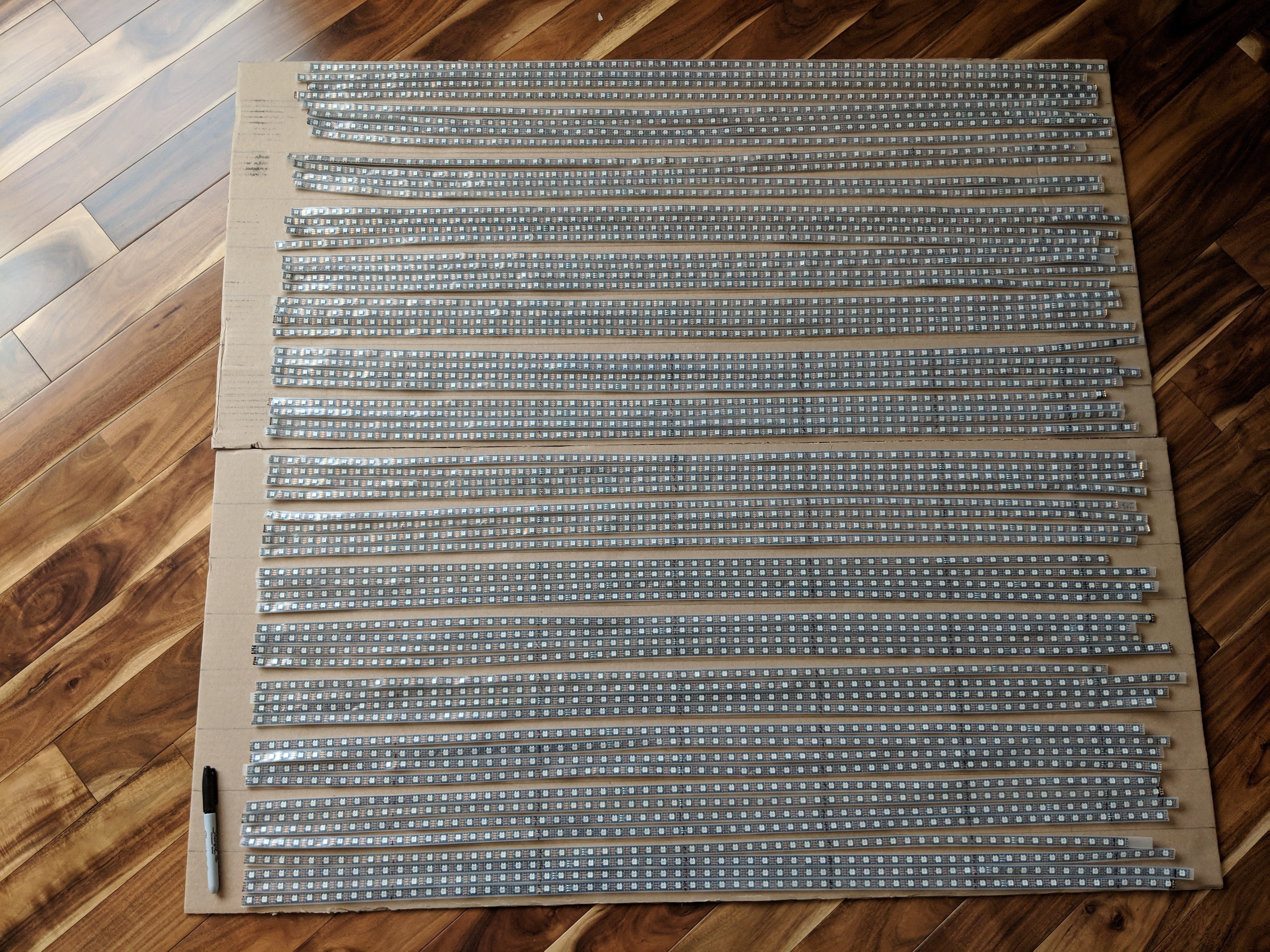

This is going to take a while (1m^2).
I inherited a bunch of strips, some cut badly, some missing a few pixels. Maybe I’ll get 64x64 working anyway, we’ll see.

I just finished my first test of 256 LEDs and they used up just below 10A (as expected) on full white. That means the whole thing at full white would be 160A, but honestly I’m only going to get 2x 60A power supplies and that will be more than enough. In real life I guess I’ll be using 20-40A average maybe?
1/8th done. This is going to take a long time…missing/deleted image from Google+
