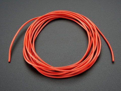

Using some of adafruit’s super flexible 26 awg wire for the interior. It’s really nice stuff and it’s soft enough to conform to minimal pressure.
