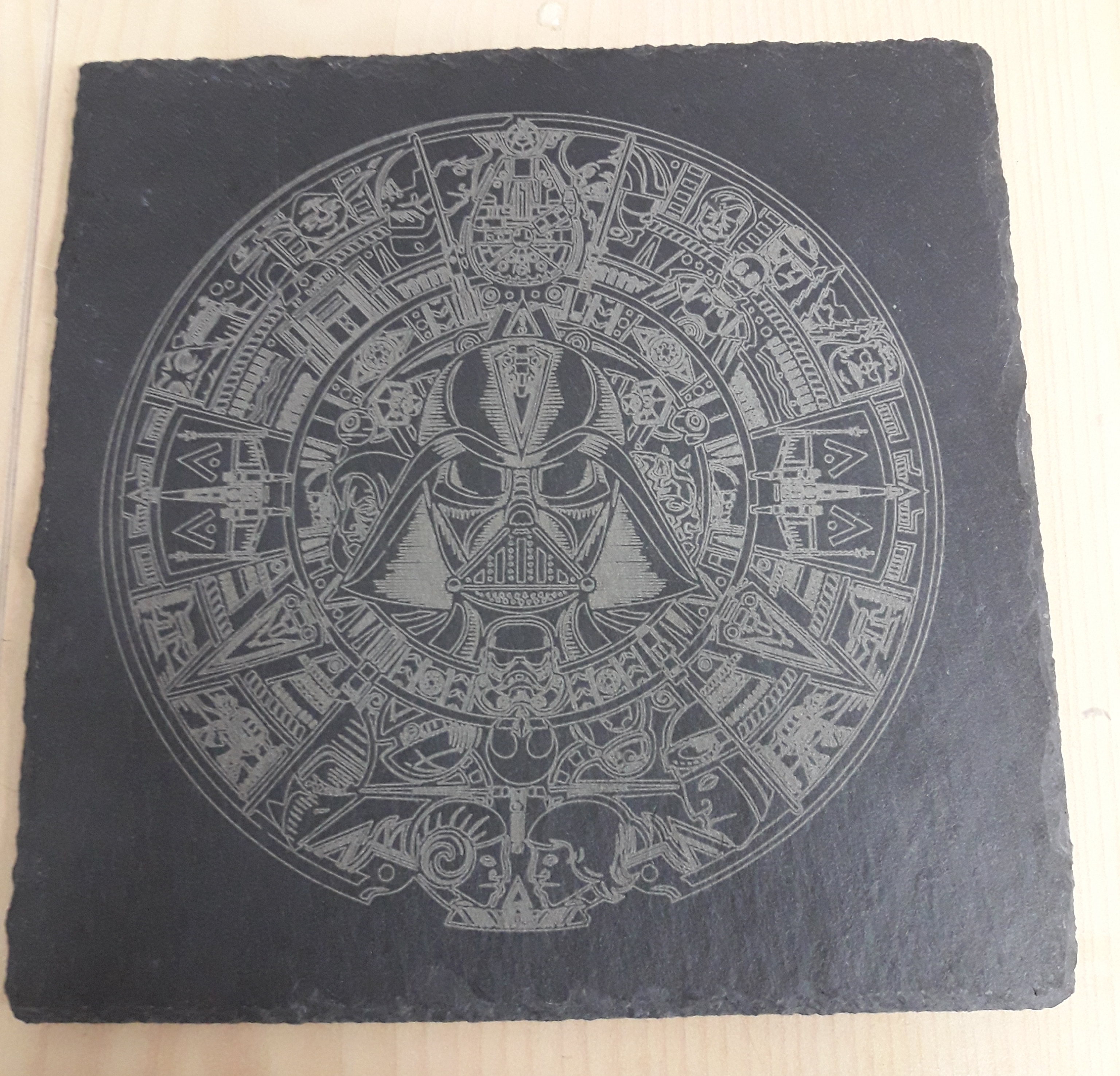

This is my first attempt on slate. Engrave on this material looks so good.
That looks really good. Is that natural slate or composite slate?
@Duncan_Caine didn’t know actually… I throwed the packaging… but in a round piece that I have it says it’s 100% natural slate. Think this was the same brand.

That will be natural slate, it gives a fantastic finish and is even dishwasher safe. I do a lot of placemats and coasters in slate and in some you will find the engraving will actually come through with a gold tint.

If you apply a spray gloss before engraving it can help the white of the engraving pop more
@Nigel_Conroy thanks, I will try it

@syknarf May I ask if you vector, or raster engraved it? It looks fantastic! I use K40 Whisperer and often wonder if I should blue line a piece or black line
@Andy_Shilling @Nedman note the “gold tint”…
@donkjr Doesn’t really look gold on my monitor. I accept that it was just a trick of the lighting. I was really surprised that you were able to get some gray scaling when you engraved that coaster. Something I’m going to play with myself.
