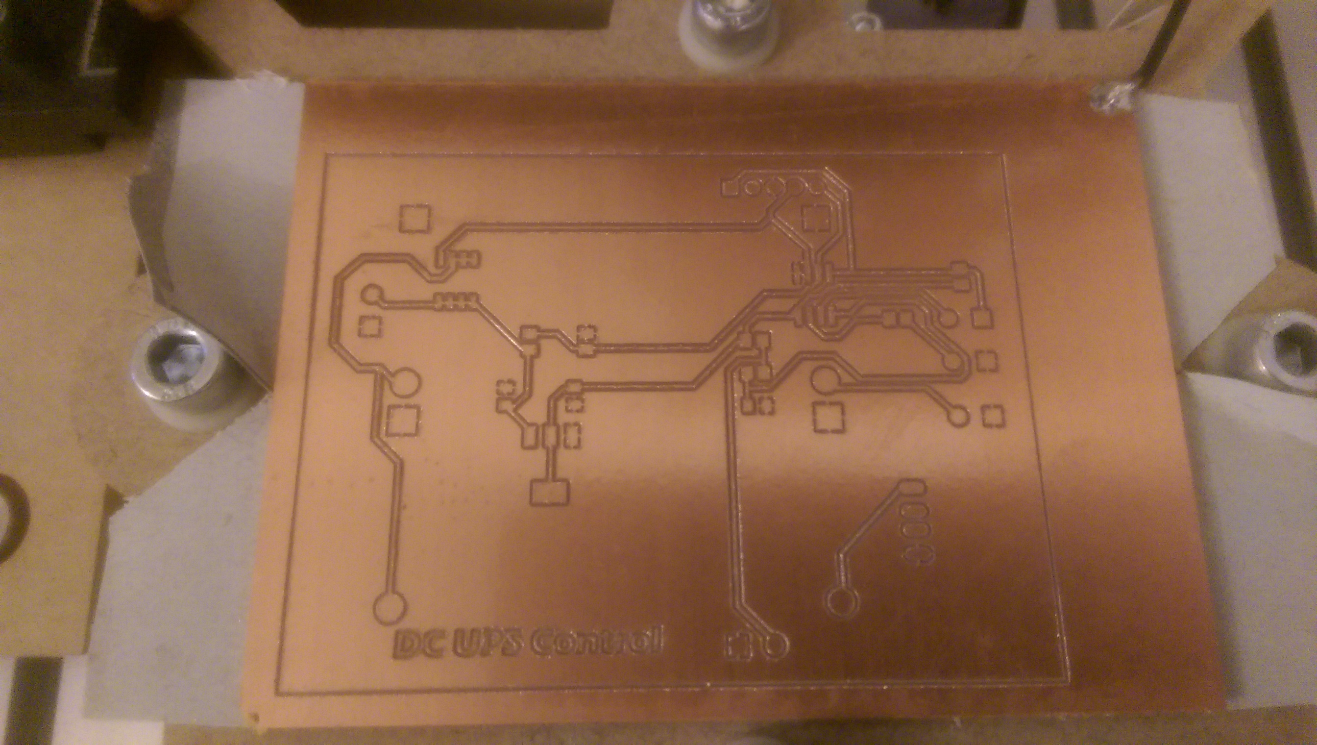

This is my first attempt to mill a PCB with Cilipeppr, I used 45 degree V-bit to mill the traces, I only have 0.6mm drill bit, so I used it to drill the small holes and I milled bigger holes and cut the board with 1.5mm bit.
Board designed in Eagle, CP generated the gcode, I manually wrote the gcode for drilling the holes.
I’m very happy with the result, Auto level did excellent job here.
