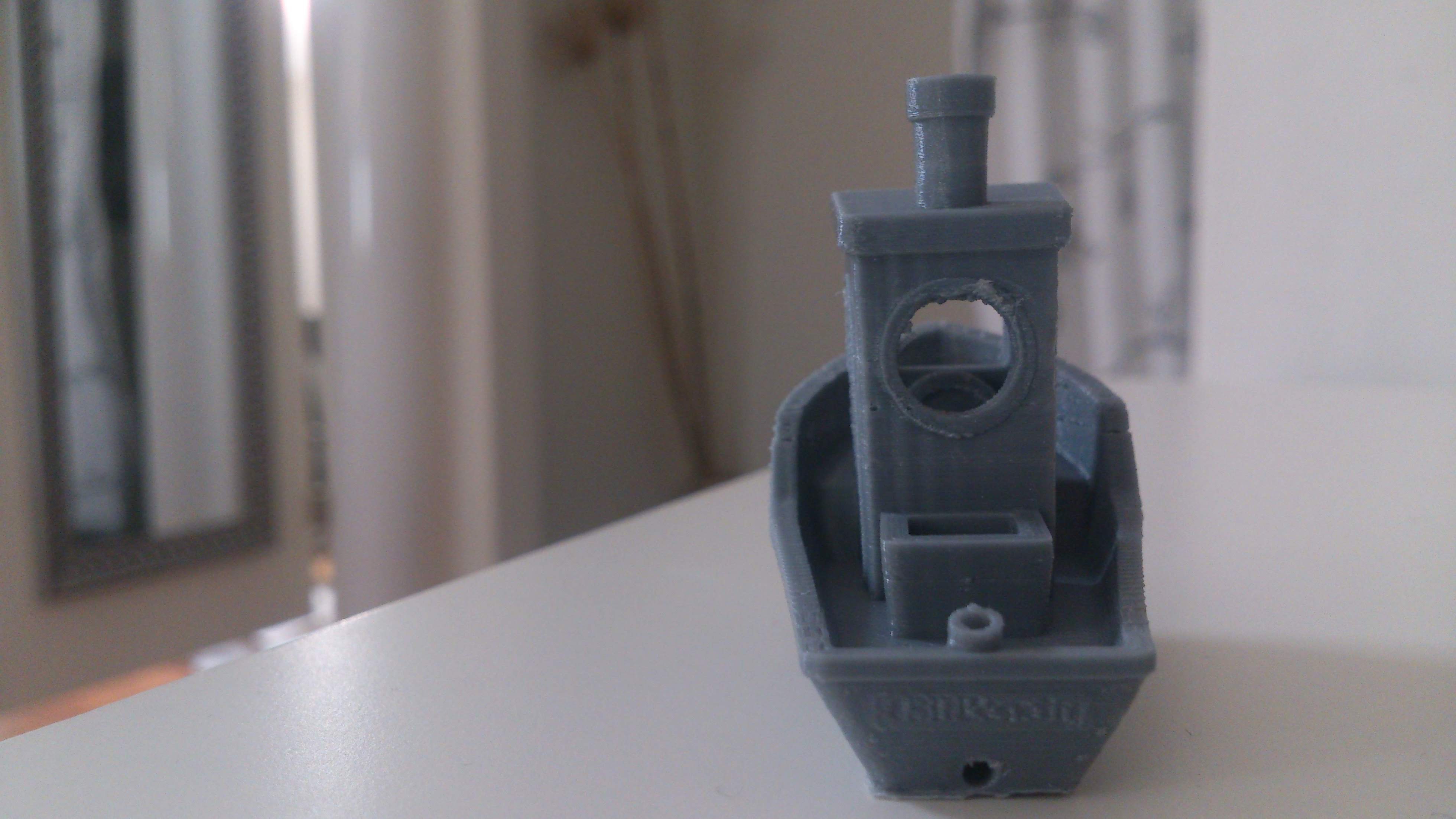

This is my first benchy! Printed with the anet a8 Prusa i3 Rate it:)
Rate it:)
You’ve had extrusion problems one one layer.
What Filament and print temperature?
What speed?
@Panayiotis_Savva PLA from Gearbest (i don’t know the specific name of it) at 190C and 60mm/s
I don’t know if it’s simply nozzle being clogged, or something else…
I suggest to try and print it at 200deg and see of is any better.
Also see if you can increase active cooling on the printed part.
