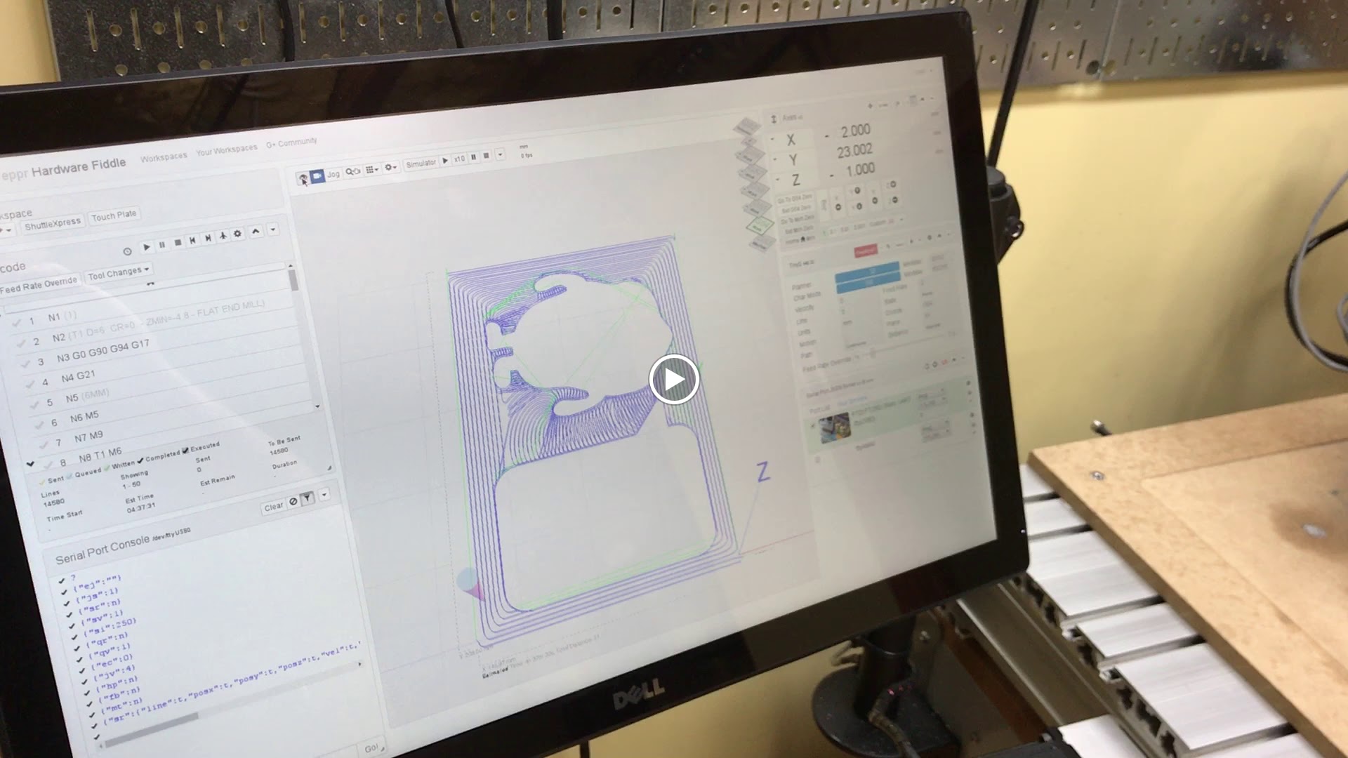

This is my raspberry pi optimized workspace with the optimized 3D viewer all running on a raspberry pi 3, with a dell 21.5" multitouch monitor connected. The gcode being rendered here would not work on the vanilla tinyg workspace at all, the pi would hang and chromium would error out. As you can see, with shadows disabled and AA turned off, chilipeppr runs fantastically on a sub $50 computer. It’s quite awesome to boot right to chilipeppr!

This is amazing that just the anti-aliasing became the most key item between it working on Raspi 3 and not working. Damn. Love these changes. Is it true as well that having the 3D viewer be full browser width/height under those other widgets also caused flickering?
@jlauer I think the flickering was when it ran out of gpu memory and started dropping mesh. Full screen does make it considerably slower on the pi however. I made some tweaks to the 3d viewer to make it work in whatever element you attach it to. I now just need to go and make sure that it still looks great when full window.
