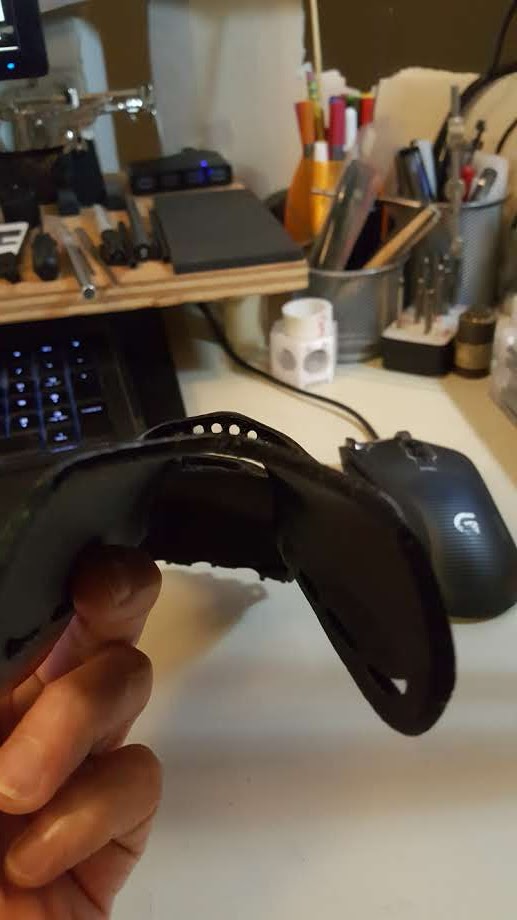

this is printing nicely so far,
this is printing nicely so far, yay!
Oh, you’re printing the K-1 from E-Nable?
What version is this? The gauntlet looks unfamiliar.
@Xenomorpheus @Adam_Steinmark It is the K1 Hand off of Thingiverse, not sure the version if there is a latest please direct me to those files. This one has issues I had to remodel the wrist hinge pins as the STL from thingiverse the base flange that holds them in place is narrower than .4mm and will no slice into a tool path.

I am going to design a prosthetic, the hinges all need to be tabs printed flat so the loops are aligned best for strength. The finger base tabs on the palm part are vertical making layer bonding the only thing resisting torque and extension strain on the hinge. Slots in the palm and flat printed tabs would be better. Might pull out, at more force than the layers will come apart, but then it would be replaceable.

@Xenomorpheus and @Adam_Steinmark OK the fingers, the pins to attach them, the knuckle finger hinge tabs built into the palm part, it’s all really bad for the end user.
Issues with strength of layer adhesion building vertical small hinge tabs. Too many failure points on one long print.
Just because you can, does not mean you should. In this case making large parts with small attachment points integrated is bad.
To my industrial design mindset this is a model of a potential prosthetic. The hinges that take all lateral load from finger to palm part need to be separate, built in horizontal loops. They will break it needs to not require reprinting the entire palm to replace them.
Not criticizing the designer it’s a good step but it’s not the prosthetic that people actually need. It needs major refining for tighter tolerances, less toylike hinges that are replaceable, thought for where it will break when the fingers catch on something, and design to make that easy to fix by a child, user serviceability.
