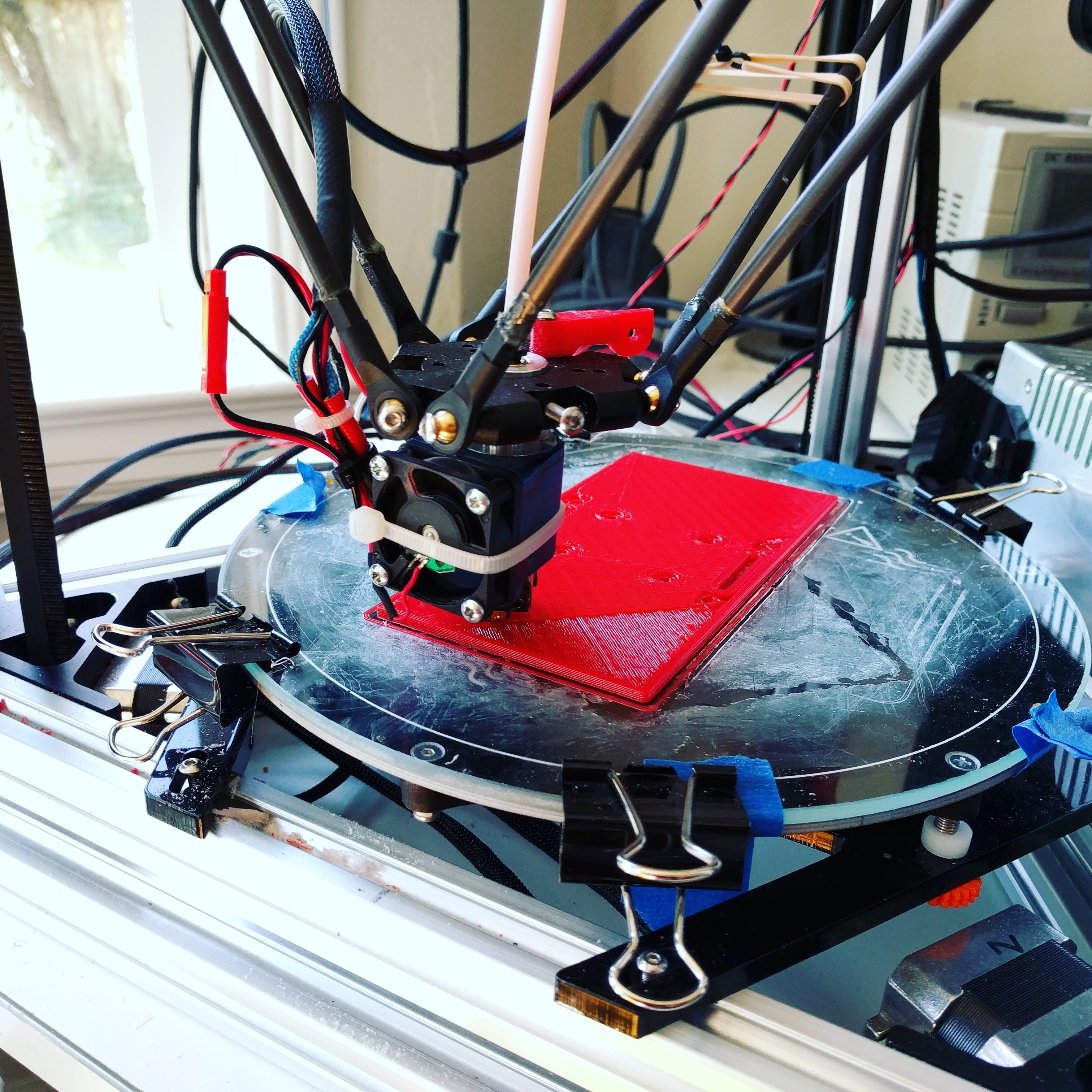

This is probably not news to a lot of you but, if you’ve never tried a 0.6mm (or I guess larger too) nozzle go and order one right now. Fat layers are awesome, prints are so fast! After spending a long time trying to print a large, for me, piece the 0.6mm solved all my first layer issues and the print looks great!. I need to try the 0.8mm now too, oh and my I “need” a Volcano too.

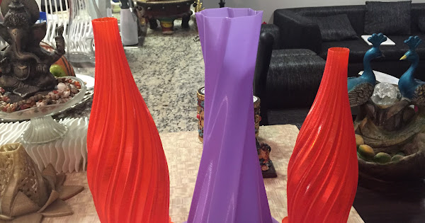

Also, in vase mode, I get a waterproof print. See these.
