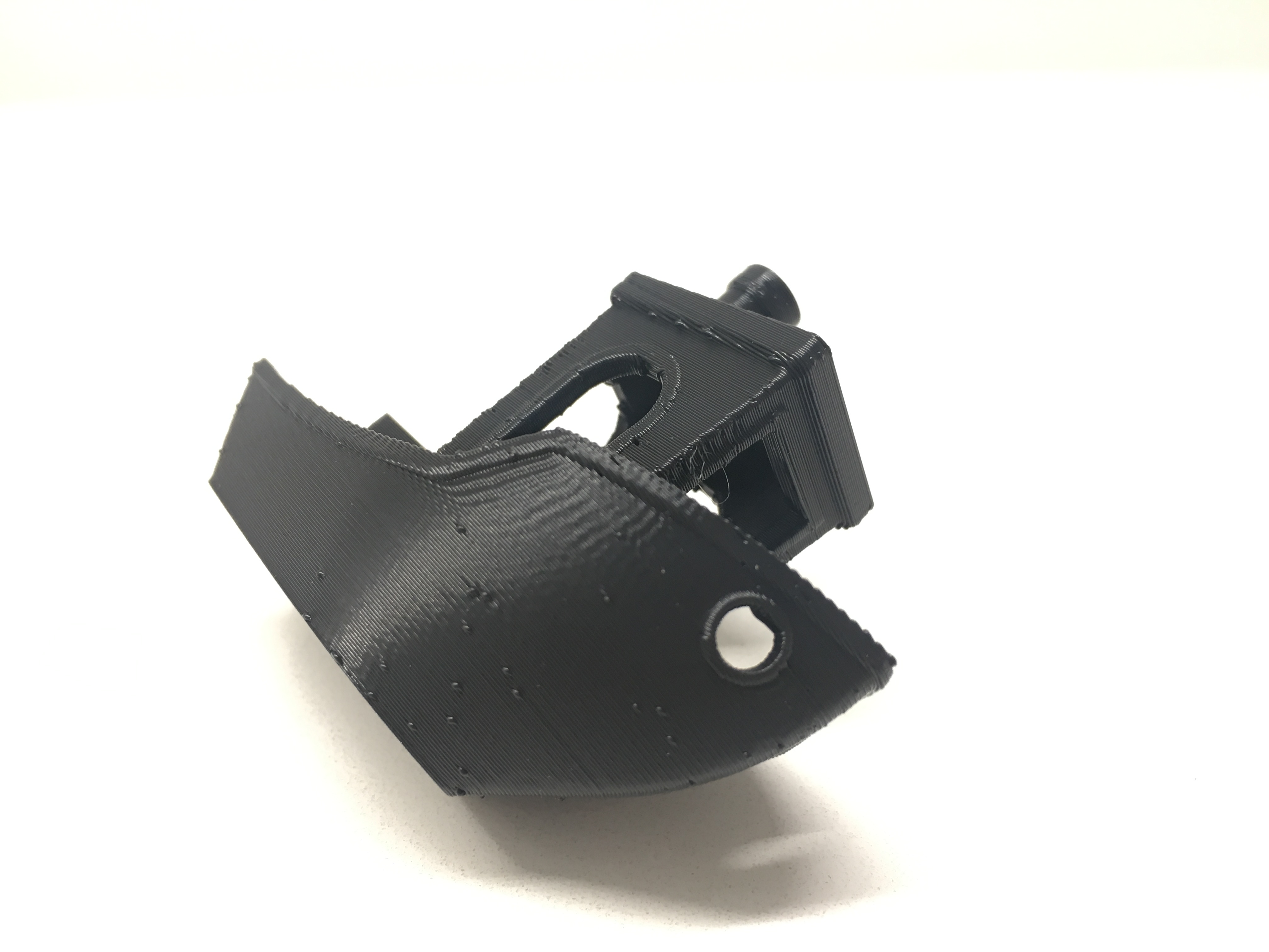

This is the best I am getting it.
Using the profile that Eric sent me(slightly modified)
Any tips? No z hop, it’s making my printer crap out and loose z steps.
Using extra restart doesn’t help the blobs and just makes airgaps.
Whats the accel of your retract? And speed and length?
Are you selecting ‘aligned z seam’ from slicer?
Layer adhesion - to me- seems mediocre, temp too low?
Does the printer hitch momentarily at those zits?
I noticed perhaps what could be slight ghosting on the bow, but nowhere else. I just noticed this on my eustathios after printing for the better part of a year, it ended up being ACC El values too high. 1500 seems better for me than 2000 or 3000
z is too low, accel needs lowering or you need to use igus lm8uu bearings. aligned z seam would’ve caused a line, this looks like random, so fine tuning retract will help. high accel on retract, lower accel on recover, speed at about 60-70mm/s, length is dependent on your tube. is this a volcano nozzle? those layers look way to big for anything smaller than 0.5. is your extrude width less than 75% of your nozzle size?

What do you mean by z is too low?
The blobs are not random, they are happening at layer start points.
Nozzle diameter is .4, extrusion width is .4 ( will bring to .48)
Coasting distance of .1mm
retact of 4.5mm
retract speed of 60mm/s
@Stefano_Pagani
z too low meaning your squishing ito the bed a little too much. Random meaning the layer change isnt aligned, the setting is random
width put at .5, set filament size to 1.72 (this is the actual size, like 2.85 is the actual size of 3mm) reftract looks good, whar is your acceleration for retract? Do m500 and look for o think m207
