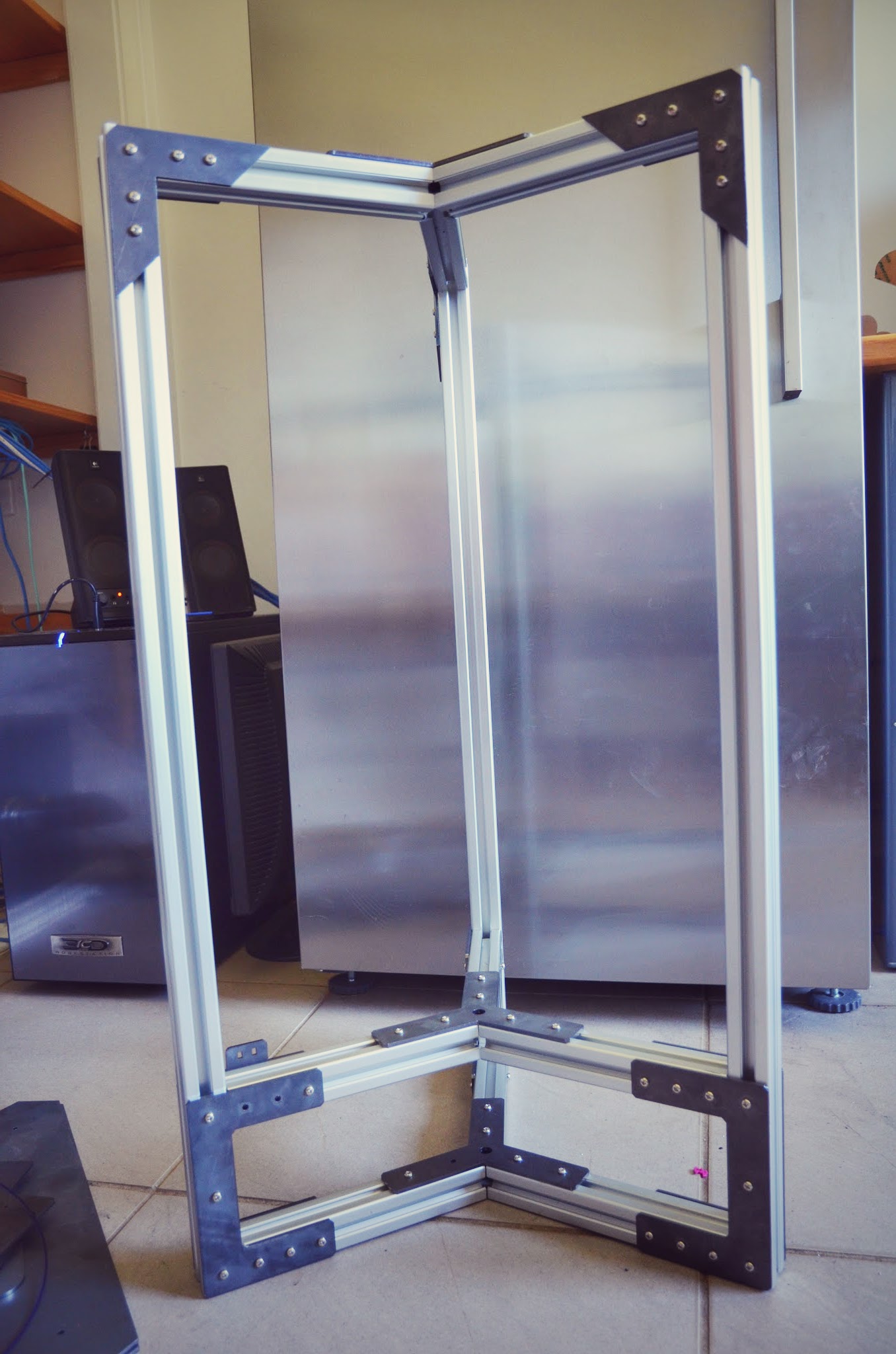

this is the current state of my delta 3d printer build,
this is the current state of my delta 3d printer build, I’ve got the frame partly assembled so i can do strength tests on it. the end effector is partly done. i’ve cut and glued my push rods, and they seem to measure +/- 100 microns which i think is ok. also i found this loctite 680 metal glue which is great for gluing metal balls to bolts for use in magnet joints.
and today i bent up the metal stepper motor mounts. i also finished drilling and tapping all my m4 T nuts
