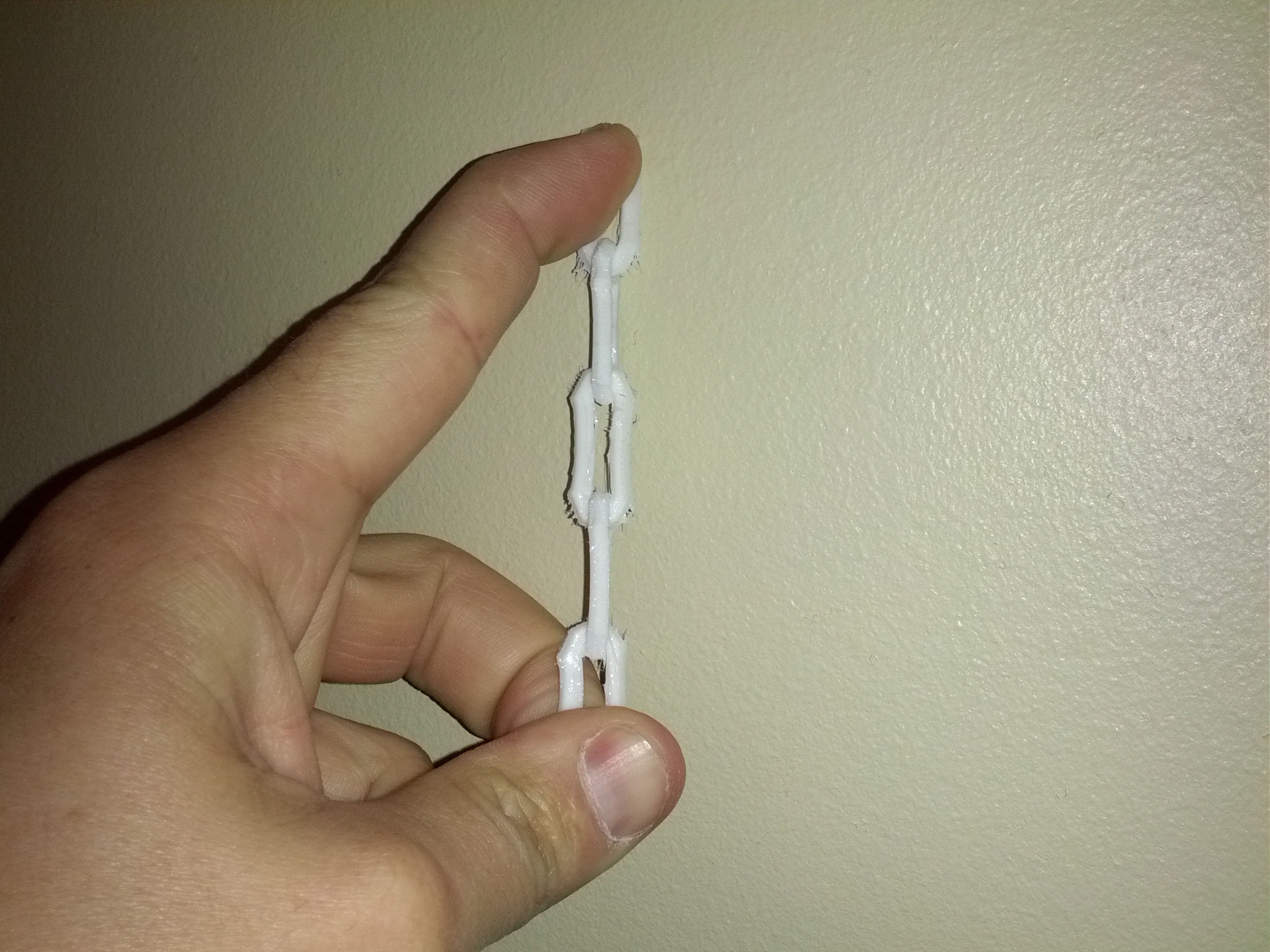

This is the first time I have printed with NinjaFlex from Adafruit Industries and
This is the first time I have printed with NinjaFlex from @Adafruit_Industries and I love it!
It is very compressible and pretty flexible too… but my @MakerBot1 Replicator 2 had a little trouble pulling it through the extruder.
Can’t wait to start printing some prototype ideas!!
