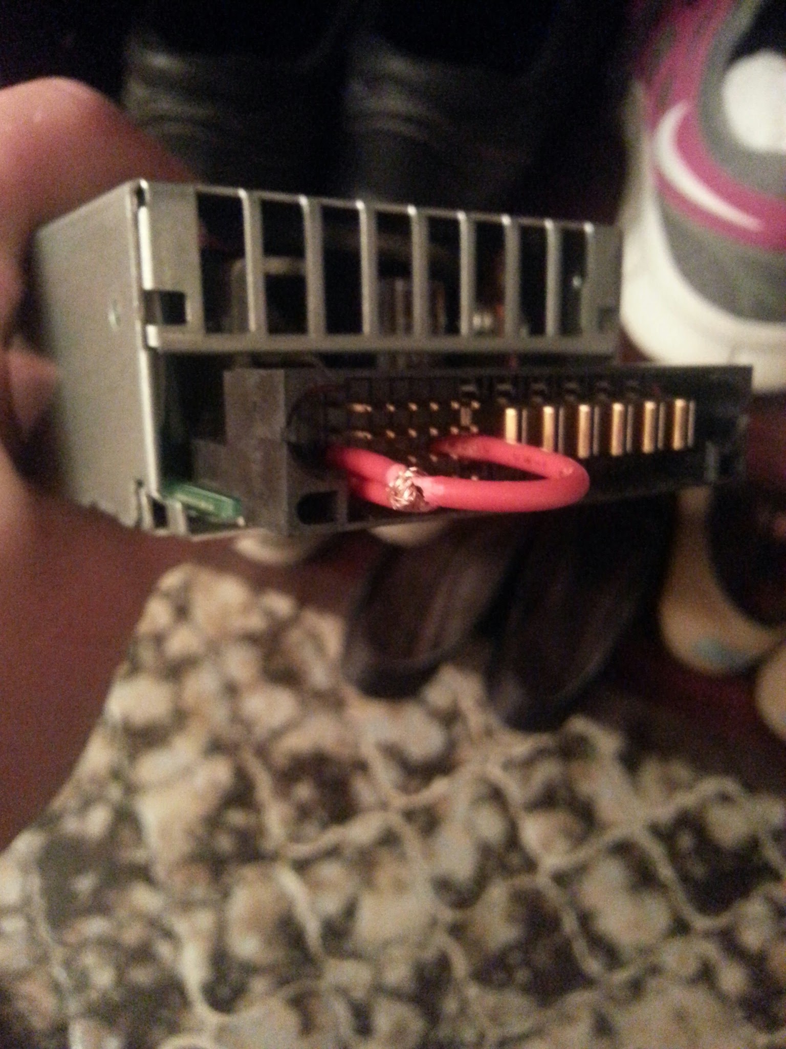

This is the jumper configuration for the dps-670 power supply for the poweredge 1950
This is the jumper configuration for the dps-670 power supply for the poweredge 1950 server 3 pins are connected. The bottom two on the left and the third from the top on the far right. I took 10ga wire cut a short length. Then cut just the insulation in the middle and pulled the insulation to bare about 3mm of wire. Took another short length striped the end and twisted it onto the bare section. Cut all 3 ends of the wire so the insulation is flush with the copper. And gently push the wire into the pins so that the insulation acts as a connector. After i took this picture i soldered the joint and put some heatshrink. After that I made a small u shape and trimmed it as close as i could it now sits about flush with the pins. puts 12.36v without a load
